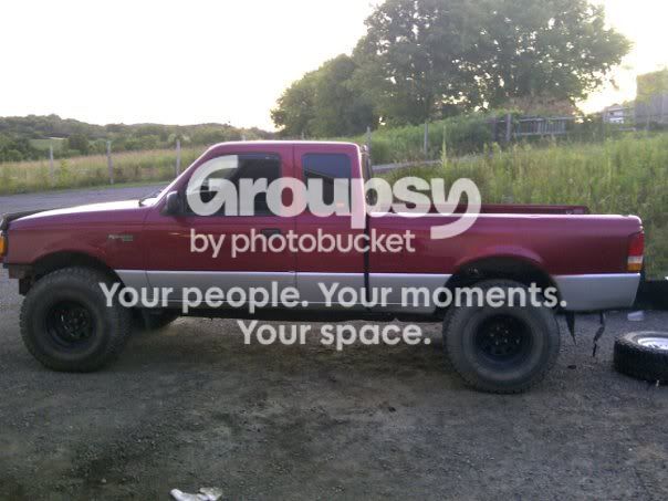

well i ve been putting off working on this truck for a long time now so last week i said screw so here is the start of my halfrunner build i call it a halfrunner because of the BL thats in it for now little bit of background behind it truck was a stock ext cab with 4l it was given to me back in grade 10 had 119000km on it just rolled 160 now here it is in its most stock form
fast foward 5yrs
heres where it is at now
took most parts from my 4wd as its going got another project along with this right now its got reversed shackles arched exploder leaves and 8.8 with disc brakes
heres just after installing the rear components
now im back to driving it its wayy different havin posi plans are glass fenders build a bed cage front rear bumbers getting bent beams gona stay coil for now build new coil buckets and im looking at running bilstein 7100s in the front havent really decided on rear shocks yet
