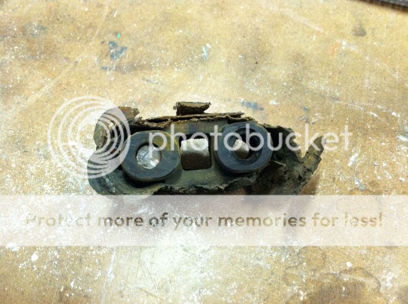

Got my new exhaust bushing in after I cut the old one out.
The reason for replacement:

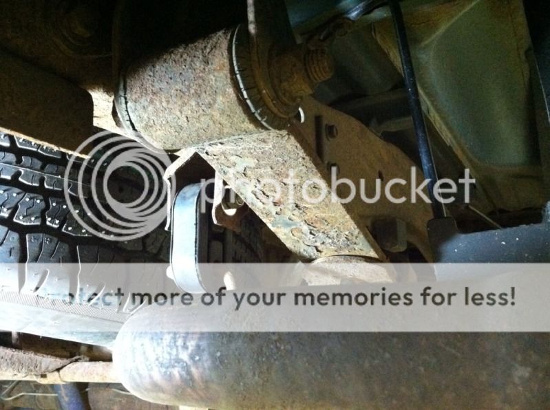

The rust is getting worse winter after winter. The paint has started to peel from the box side wheel wells. I'm not too worried, it just has to get me through the last two years of college. However, I am trying to find a 4WD. Haven't had ANY luck lately, the last 3 or 4 trucks I've looked at have all "looked" nice on craigslist but turn out to have quite a few issues upon looking at them.... so the hunt is still on for one. In the mean time I'll keep churning out the miles on this guy and hoping for the best!
