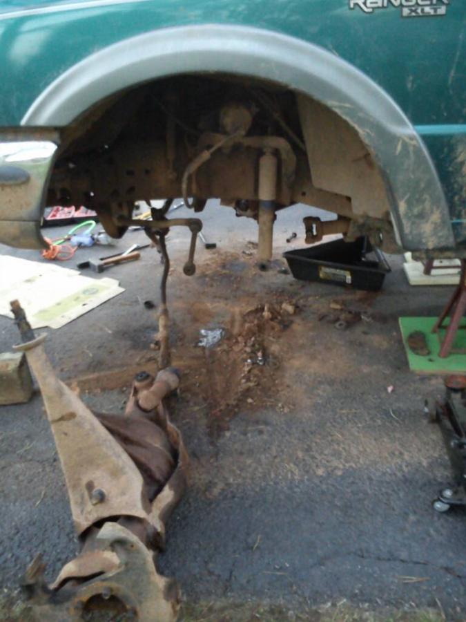

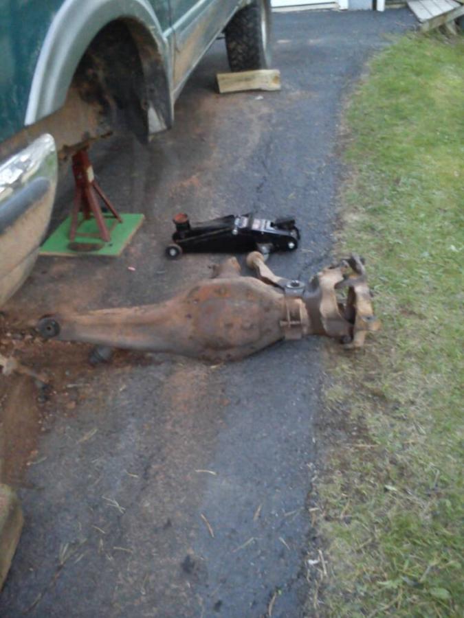

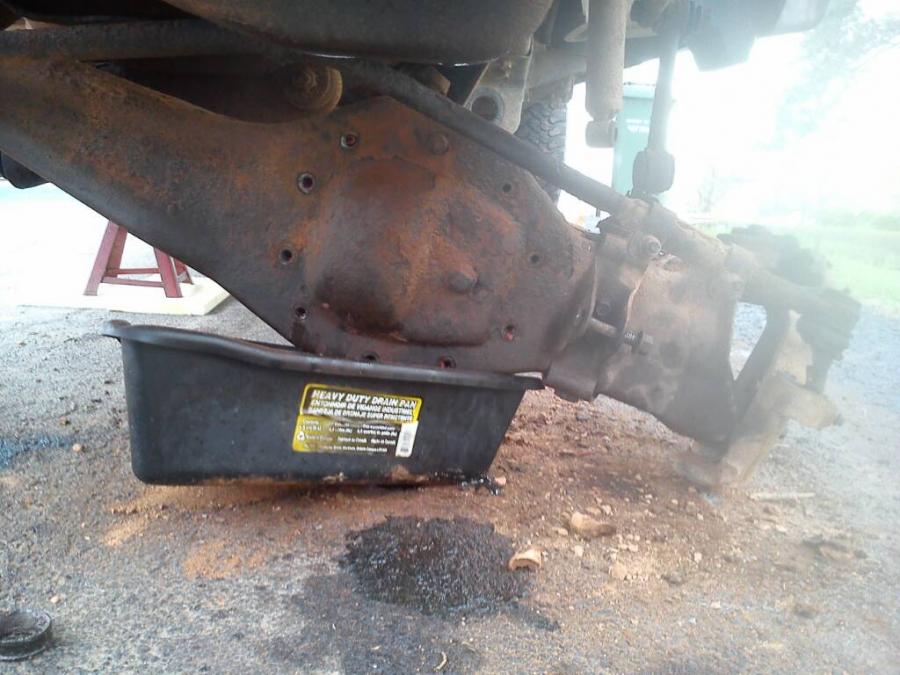

Started tearing out the d35 on monday doing a few hours every night this week. Most of it is going pretty smoothly, although my coil retainer on the driver side is pretty much non existent and the threads for the stud are pretty well screwed. Im also stuck on the driver side beam pivot bolt right now. Going out the try to get it to move today, dad and i got the nut off of it last night. Ill try to get pics up tonight
I've been sick all week so dad helped out a bit by chopping up the stud on the driver side and the pinch bolts for the ball joints. I got the driver side beam dropped today. I just had to undo the tie rod from the passenger side knuckle, then swing it out of the way, stuck the breaker bar on the bolt and jumped on it lol worked like a charm. Think I might drop the passenger beam too and blast and paint while I've got it all apart
