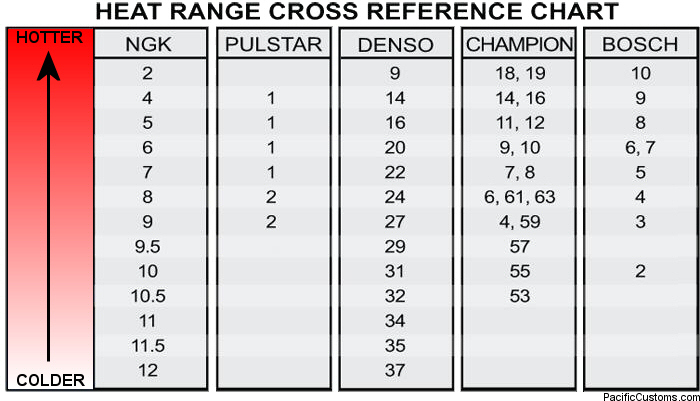

I have heard that I will need to run colder plugs once I put the supercharger on. Looking at running NGK 7993 plugs. They are heat range 10. Plug chart:
My questions are:
Are these too cold? Am I going to wind up carbon fouled to hell and back?

2.9l used the Motorcraft AWSF-42C, so heat range of 4, Motorcraft used 10 as HOT, 1 as Cold
Cross reference to NGK shows NGK TR5 as the match, so NGK heat range of 5
Rule of thumb is 1 heat range cooler for 75-100hp increase, so 10 sounds a little too cool
Stock 2.9l is 140HP, if you were at 340HP(+ 200HP) now then an 8 would be better
Its always BEST to run too cold a spark plug, you just get a fouled plug, if plug gets too hot then engine damage can be the result
THANK YOU ROND!
Figured I was a little too cold, but would rather be on the safe side.
