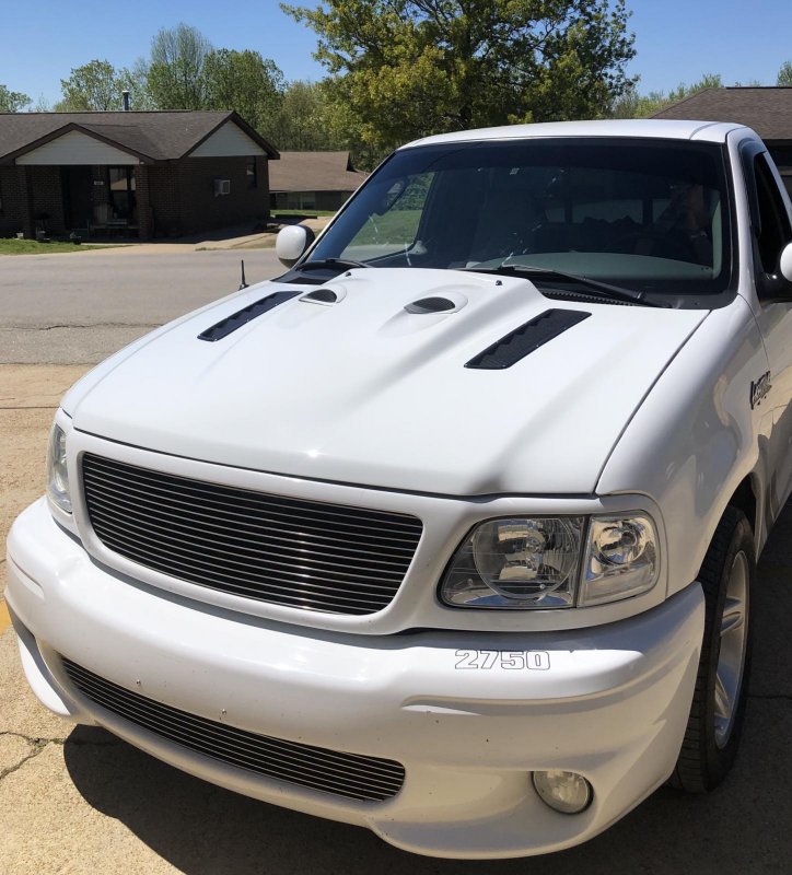

My Ranger doesn't even have squirt nozzles. Hasn't for years. That's a good idea, using it for water/methanol injection. I already have a small pipe in my tb that's plugged as of now. With the right size nozzle, it could work. I wouldn't have nozzles on my Lightning, but the new hood a guy in Missouri made for me, has the holes already there. I suppose I could've told him to fair them over before he painted it, but I actually never thought about it til it was too late.
