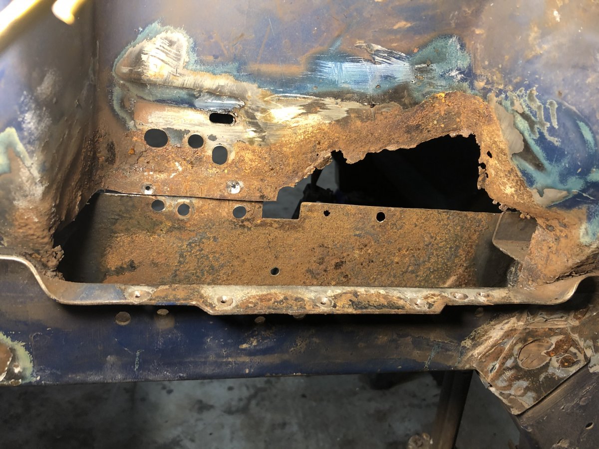

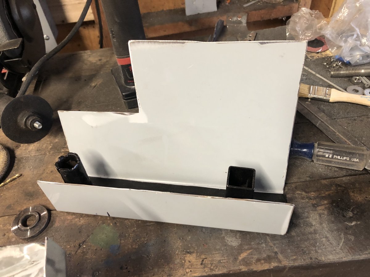

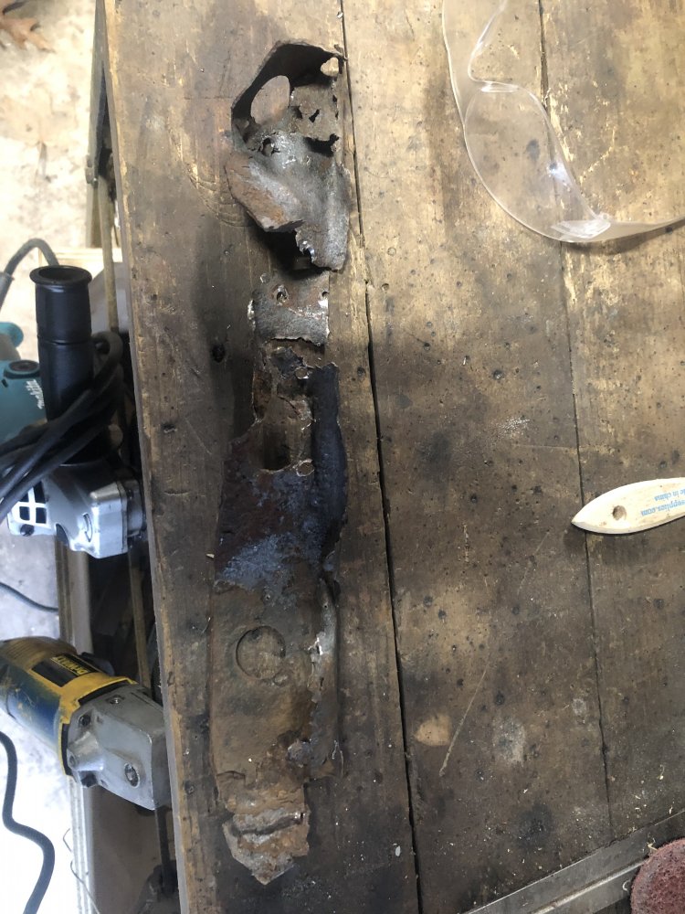

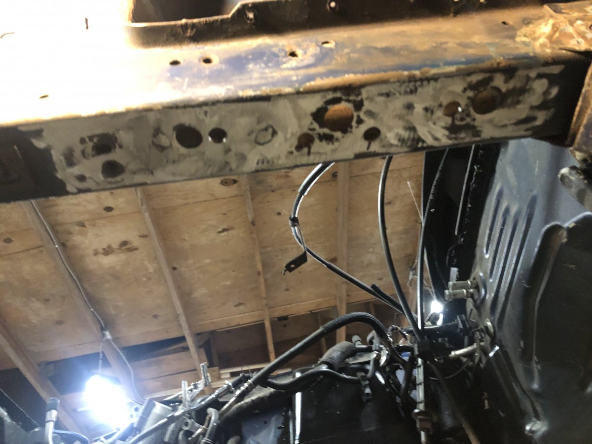

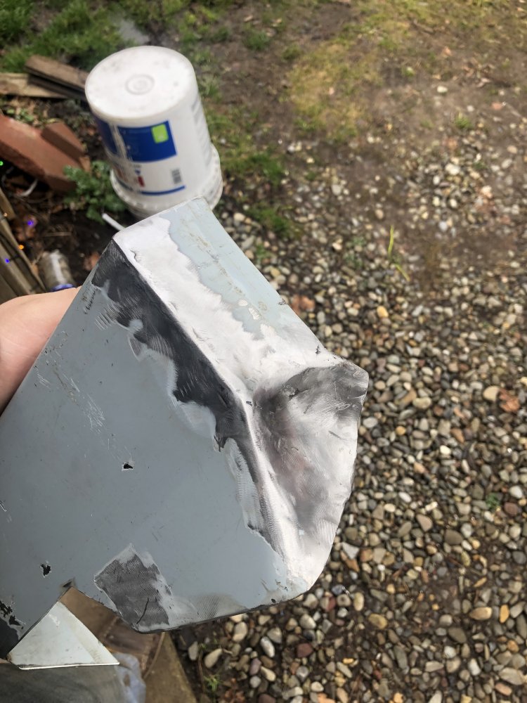

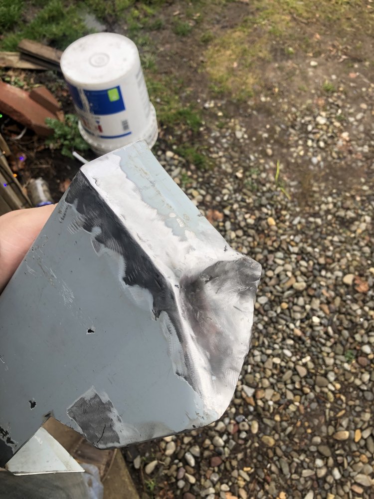

Finally got out this pos out from the bottom of the frame rail.
Had to drill holes from the bottom and push it out from the bottom. Then weld the holes back up

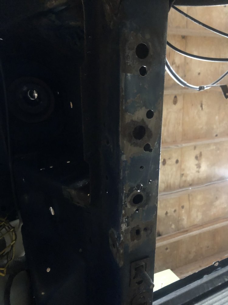

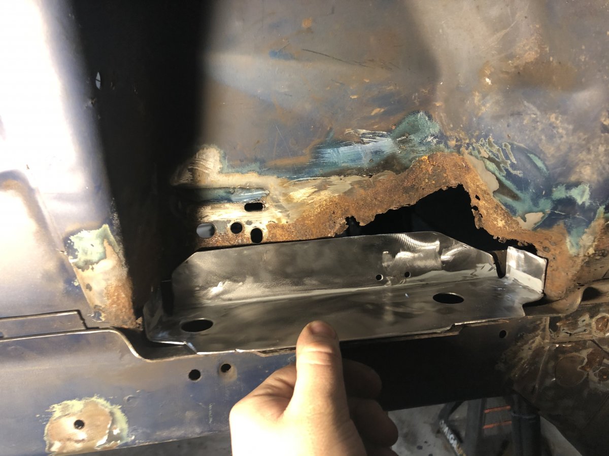

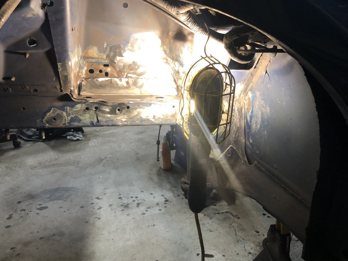

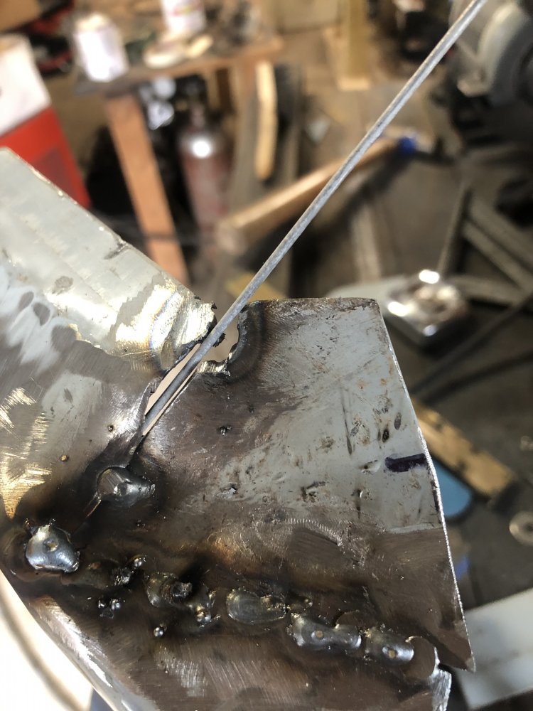

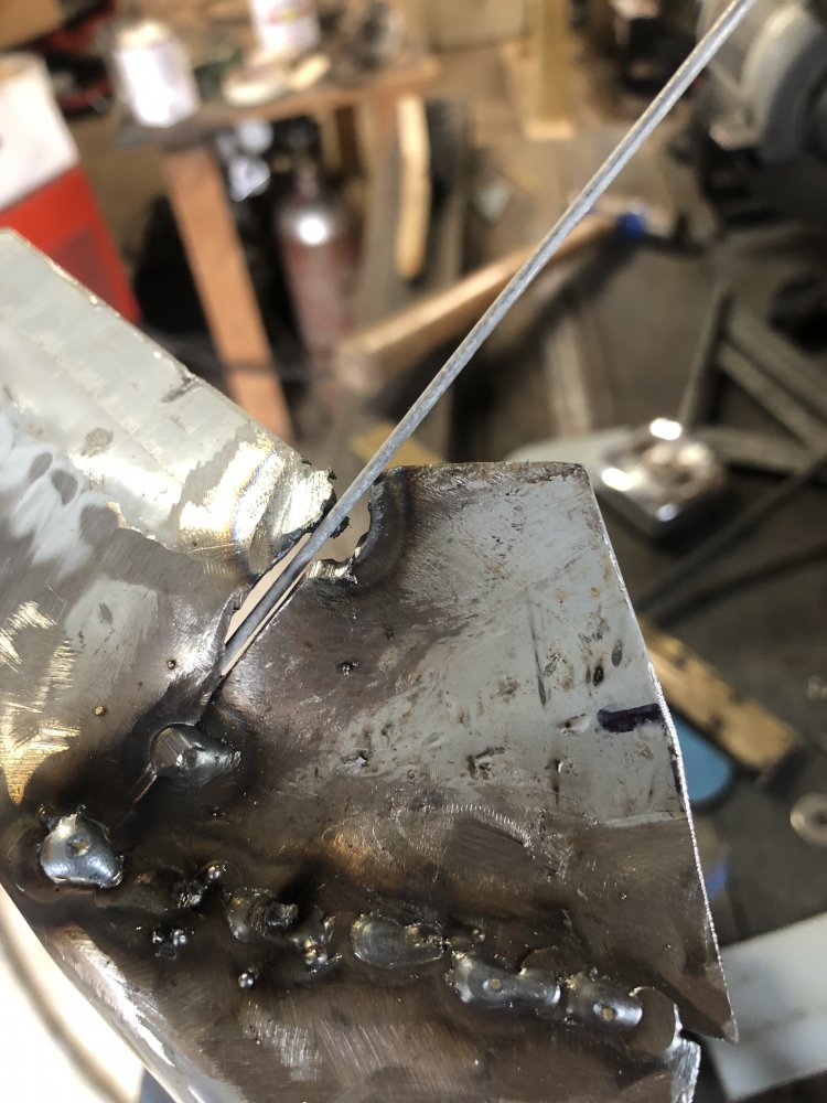

Did a bad job with the fit up on the last edge i needed to weld up, so I used a 1/16" 6013 rod that I scraped the flux off to help bridge the gap. I've seen this trick used to weld a gap from both sides with an Stick welder, so I figured why not. Cleaned the flux off so I didn't end up with a bunch of slag in my weld.
View attachment 70132View attachment 70133
Huh. Good trick. Now in brain.

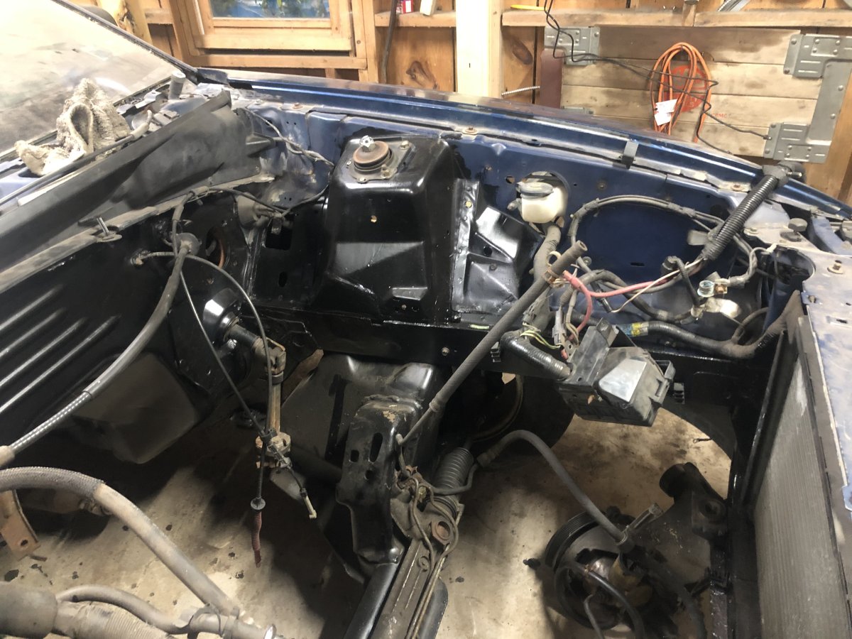

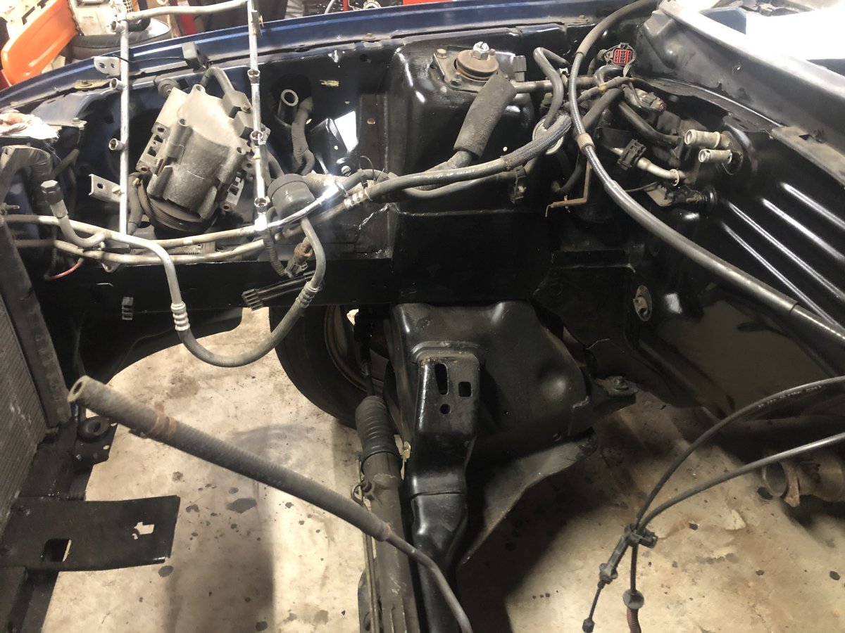

Once everything got painted I rebuilt the whole suspension. All new prothane poly bushings from LMR, Ford Racing springs, KYB shocks, MOOG tie rods and ball joints.
Haven’t decided what to do with the brakes, fairly new stock setup them when I took them off. So I will probably just put that stuff back on.
Couldn’t find the caliper bolts so I just put the rotors so, that way I could set it on the wheels.
I should really strip the engine down so I can check it out and order parts.

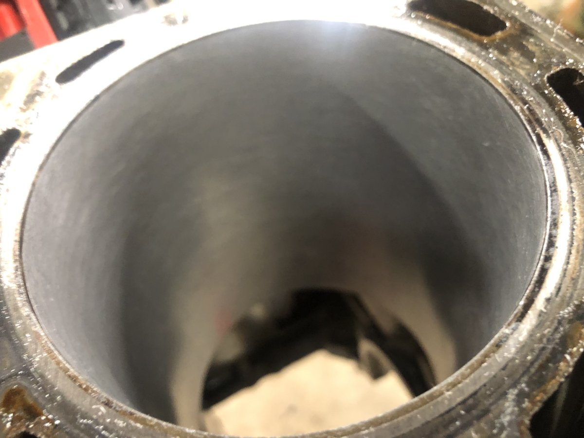

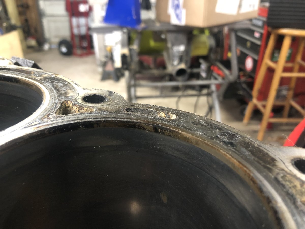

I pulled the cam bearings and started to hone the bores. Super happy with how the bores turned out. No low spots or carbon ridge at the top.
It’s hard to see in the picture, but the cross hatch is pretty close to 45*. So it turned out great for a hand job. Did four of the six.
