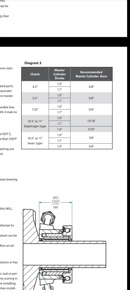

So I was reading some dead threads about 7/8 bore masters and the lack of accessibility. I want to go with the Tilton internal slave but I would need a 7/8 master for the 10.5 clutch in the T5. I know many of these master are advertised as 7/8 but fall short. So besides making an adapter plate and push rod for a wildwood or similar priced master, What is a bolt on solution anymore. I was thinking about the modern driveline external slave since the Nissan slaves are such poor quality anymore and wiped out my mcloed clutch this time when it leaked around the bore.

That's what I have on my t5 is the modern drive line external slave kit.they only require a 3/4" bore for proper functionality.works great for me so far
I remember reading on modern driveline or tiltons website for the internal slave they required a 7/8 master for the clutch size I wanted to run.
I'm honestly questioning whether they ever existed to begin with.
So am I....
Tilton or MDL claims some of there concentric slave cylinders require a 7/8 bore master.
Which I believe they are listed on rock auto for a f150 as 7/8 but that isnt necessarily a bolt on option. When I was buying parts for the M5OD-R2 I had in the ranger.
69599
I'm running a 10.5" clutch with mdl external slave and they told me a 3/4" Bore is recommended to run it.i called them to verify it
What's the difference a lever type and a diagram type?and which 1do I have.ranger OEM clutch master?
