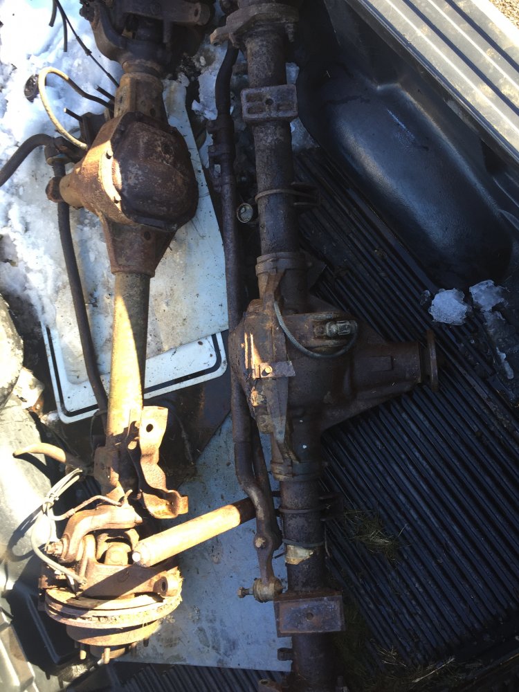

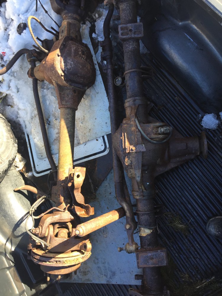

Cool. Looks like you need the brake caliper brackets and stuff for the rear too, fortunately those are available new with the calipers and are not super expensive.
Artec makes truss kits for those Super Duty axles. I would highly recommend that regardless of what you do for springs... it makes the axle a LOT easier to work with as far as mounting locations for shocks/springs/links/coilovers etc. Otherwise you are probably welding something to cast iron on the driver's side. That is the ONE really big problem with using SD front axles...that little stupid stub of tube. Back in the day we put SD axles in my buddy's Dodge and it was really a cluster fudge trying to find places to attach his 4 link brackets and ORI shocks - nobody was making truss kits at the time which would have made it a LOT easier.
Actually I got the rear discs, pads and calipers as well, you just can’t see them in the pic.
Cast iron? Huh, didn’t know that. To be honest I’m thinking I might go leaf spring in the front just for simplicity.
Then I would have the only ranger with coils in back and leaves in front!! Lol!!!
I’m not into buying stuff (although it would make more sense so thanks for the tip) I might look at it and copy it, but I’ll make whatever I have to.
I’ll tell you what though, dragging that front axle from his truck into mine...holy frigging crap is that ever heavy.
Just stopped at Burger King so I’ll jump out and look at the diffs a little more closely.
Yes... the outer C, then a little piece of mild steel tube, then the leaf spring pad/axle housing. That's why the truss is nice, not so much for strength but more for mounting things to. That tube is just too short. I think it would be super easy to copy... make a cardboard template and start cutting!

Can’t see it as well in the pic I posted, here’s a different angle.

Yep, 99-04 has leaf springs, 05+ is coil sprung with radius arms. I imagine you could clean up your axle in a similar fashion though.

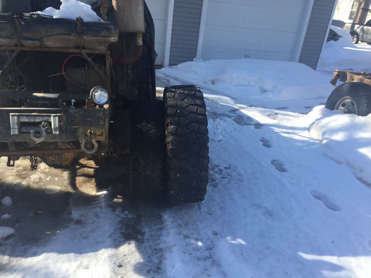

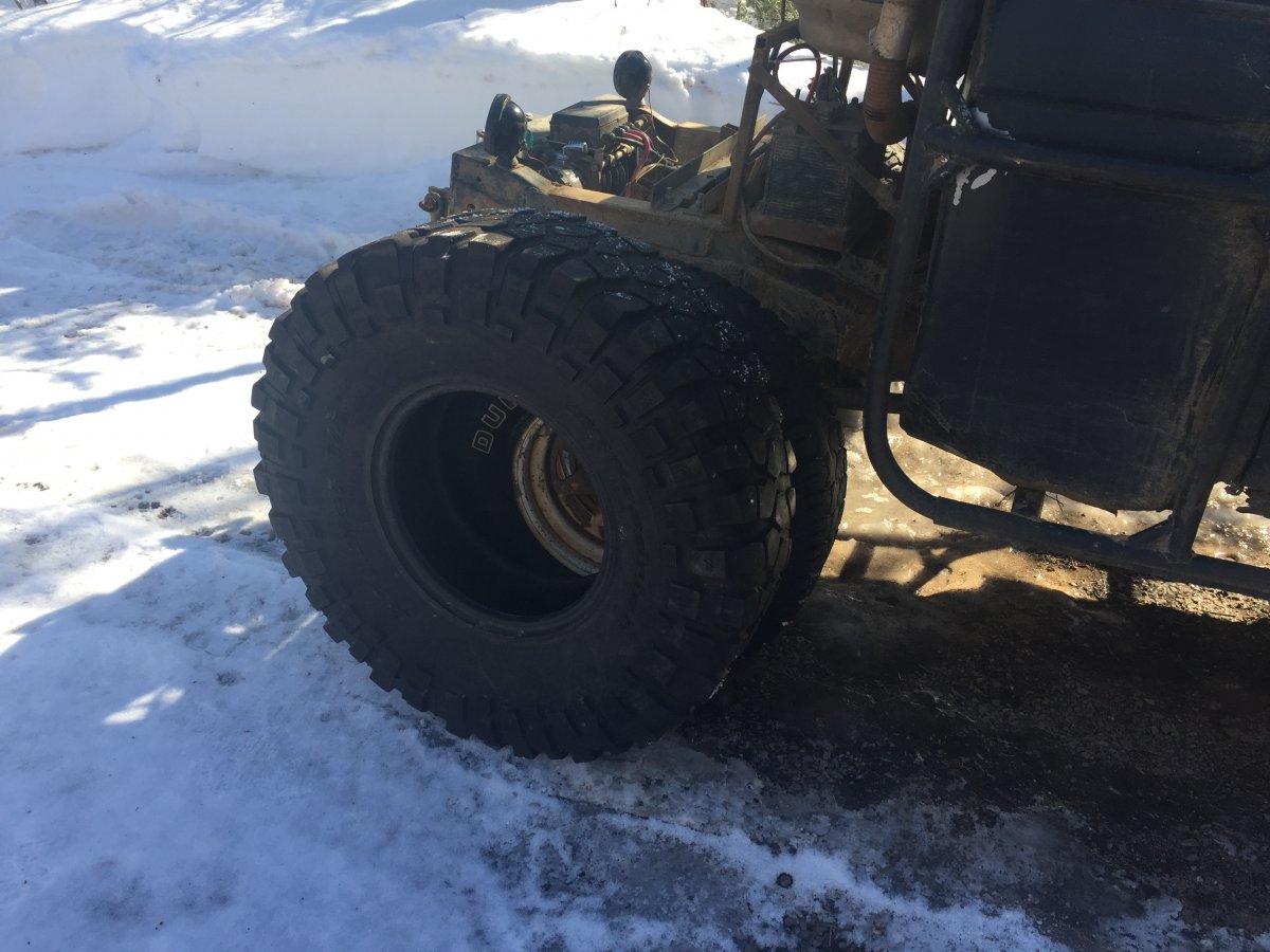

Also, picked up 4 17x7 1/2” rims for the one ton axles and then went and picked up the tires. Here’s a pic of a tire beside the 35’s.
