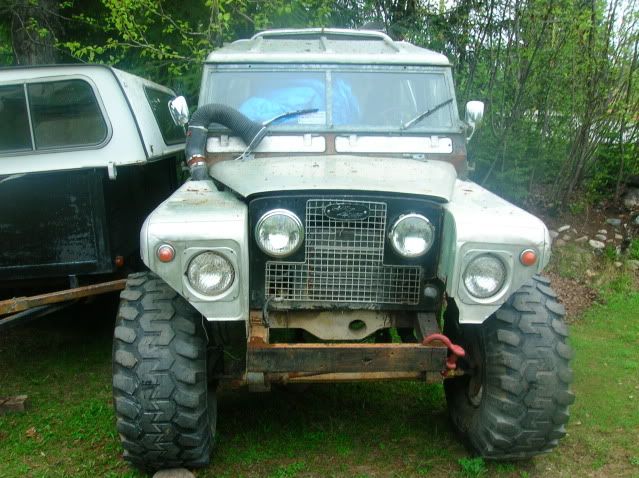

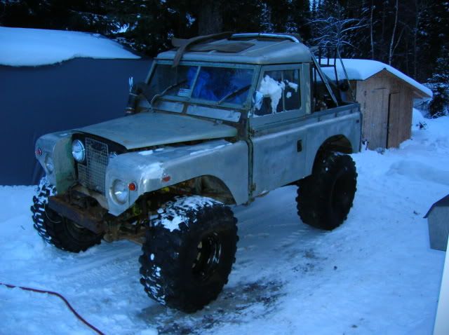

She is my pride and joy..... "1968 Land Rover 88 series 2a Station Wagon" (NO IT's NOT A TOYOTA) I've had her since the mid 90's and she's been romped hard and rebuilt several times over the last 15 years. This time around, I swapped in another very healthy small block chebby350 on a custom engine cradle I built, swapped out the th350/np205 for a th400 stage 2 shift kit sitting on a custom cross member I built, np 205 twin sticked for front digs and extra supports holding back of 205. I kept the SOA Lincoln locked Toy 8" diffs, only this time I installed 4.37gears ifs hubs up front and 2" spacers out back and disks all around, I also swapped in a GM 1/2 ton brake master cyl, I stretched the wheel base from 88" to 96" with redrilled leaf spring center pins, I kept the dual 2.5" exhaust into stacks with Dynomax 40's only this time I added full length Hooker headers and Dual Optimas, I also added an engine oil cooler w/fan and trans fluid cooler w/fan up front and kept the rad in the box with dual fans, kept the pack rack and roll cage, and grooved the balding 40x17x15 Gumbos, I recently swapped in Scout II Saginaw steering box and GM 1 ton pump, modded for higher flow, I also swapped a complete GM wiring harness and fuse block in there and rewired everything front to back, She has an old 8000lb Braiden elec winch up front, RCI racing seats and harness inside, and came with the factory removable top, doors and fold down/removable windshield.
I need a huge decal saying "IT'S NOT A JEEP OR LAND CRUISER", LOL, I can't even begin to count how many times it's been called a Jeep or Land Cruiser by uneducated so called 4x4 guys.

This is where she's sitting as of now, waiting patiently for me to call er into action again.
I have been taking her apart and rebuilding/modifying her over the last few years while I romped the Deuce out of the Deuce, lol.
Here's a comparison pic, showing the size of the Rover beside the Bronco on 35's before I fw sas'd it.
