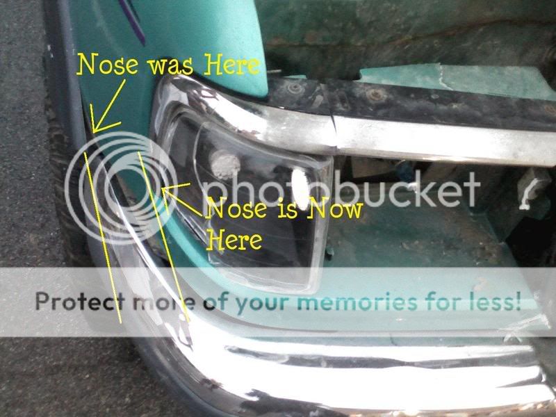

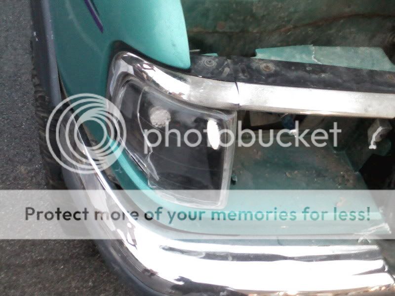

Thanks for the info about straightening my frame. Now its definately bent. I got hit today by this '07 Infinity and now my nose is 4" off from the cab. My hood won't shut, my lights are busted, I had to remove my fanshroud so the cooling fan could spin, cracked my windshield, bent my tierod, and my LF tire is cambered out.
I only got 2 miles down the road, after putting my "Chicks Dig Body Damage" sticker on.
All the pics are after we used my buddys winch to pull my bumper back out a foot or so. It was pushed into the tire with the tire turned full left.

The front of my truck is so bent the hood won't shut and it overlaps both fenders. Physically there's not that much damage, but all of the impact was on my bumper and frame. I got ahold of my buddy who has a frame machine at his house, we'll pull it back, I'll buy another set of lights, and I'll be set. I just want my hood to shut and be somewhat aligned.
Bobbywalter I agree, It's a Ranger not a Ferarri, but the damn hood has to shut.
