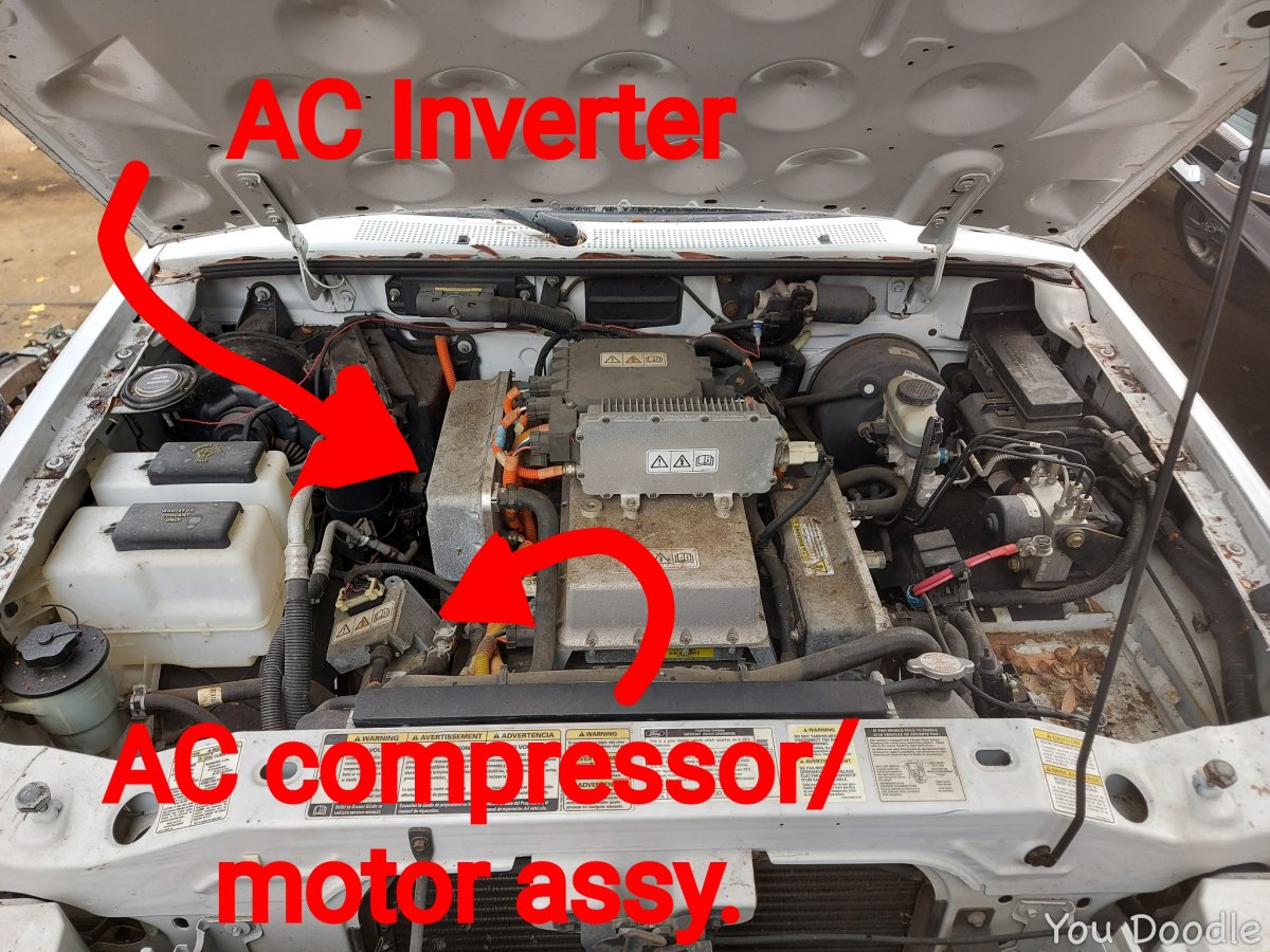

Fun fact, the factory 2000 Ranger EV I own (which happens to be up for sale) is also outfitted with electric A/C. It uses a 5kw inverter and 3 phase AC motor to run the compressor. IIRC, it is rated for up to 5kw, and it also runs on 300v+.
