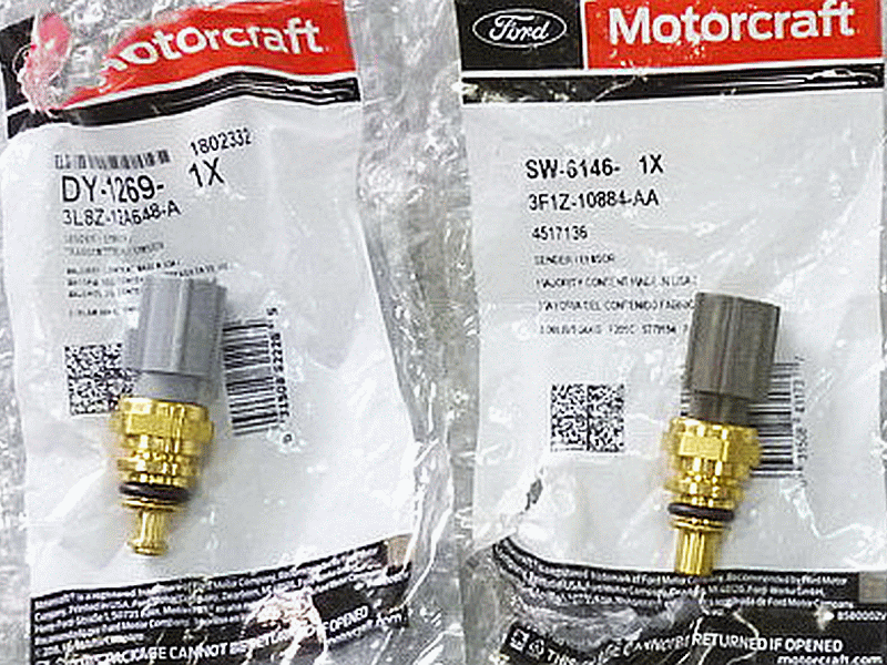

I have a aluminum thermostat housing and I noticed coolant on the housing. I thought the bypass hose was bad, so I just replaced that and now it looks like the sensors are leaking. The housing is only a few months old so I'm wondering is there a fix or do I have to replace the sensors?
I’m pretty sure they have an o-ring.
Replacing the o-ring should fix the problem. Look at the hole the sensor goes into and make sure it’s smooth. All it takes is a piece of dirt or a hair to cause a leak. So, even a scratch can cause a leak.
I was trying to decide if I should replace O rings or the sensor. As I mentioned the whole housing is only about 4 months old. I was trying to figure out if there is a difference in the sensors. They are both the same color and because they came with the housing, I didn't look that close at them before it was installed. I'm also wondering if the O rings a special or can I put one from some that I have as long as they fit tight enough?

I’m not sure on the sensors. Mine only has one and I reused it. Even though the housing is relatively new, the sensor could have been around a while when they put the kit together and the o-ring hardened up due to age and not being exposed to something to keep the rubber pliable.
I’ve also seen new o-rings with defects even though the rubber itself was in serviceable condition.
As far as just replacing the o-ring or the whole sensor, that will depend on cost and availability. How much is just the o-ring going to cost and is it readily available? If it’s only $0.10 but will take 3 months to get, a whole sensor with a new o-ring would make more sense even though it would cost more.
I just looked at some O rings I have and the ones I have don't seem as thick as the ones on the sensor. I happen to have a couple of sensors I kept from the first time I changed the thermostat. I'm going to the local hardware store to see if they have some that are a better fit.

I finished it about 1 1/2 hours ago. When I started it up to check for leaks there was coolant gushing out around 1 of the sensors, so I shut the engine off and checked, I had not gotten the clip in right the sensor had come up, so the clip was underneath it. I corrected the error and tried to clean up some of the coolant, while it was running. It appears to not be leaking but I lost more coolant than I thought because when I moved the truck what I thought was melted snow had some coolant in it. Have to by some more coolant tomorrow and fill it and check for any leaks again.

For the ClipMounted TempSensors, have found OffBrand\NonOEM ones
often have cheap thinner springwire Clips compared to MotorCraft, that do not hold as tight.
Gotten in the habit of using a smear of RTV around the ORing\Threads on TempSesnors, to help prevent leaks.

Yeah, those clips for the sensors can be a bit of a bugger to get in right. Glad you got the problem fixed.
