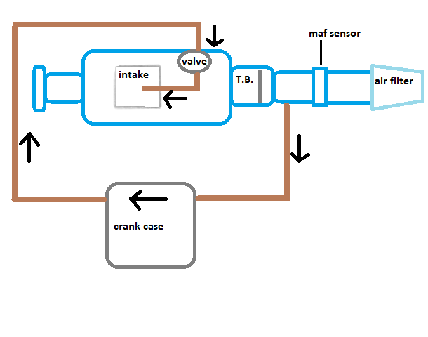

Your pcv valve is connected directly to engine vacuum pulling air OUT of the crank case to be burnt by the engine. The other line on the intake side allows fresh air INTO the crankcase. This air coming into the crank case has to be metered. When the fresh air side is disconnected the pcv system is now pulling unmetered air through it. (I.e a major vacuum leak).
The fresh air side of the PCV system is not a vacuum leak. It is before the throttle plate. It is always allowing air to enter the crankcase... just in this case... it's filtered vs. non filtered air entering the crankcase.
It would allow unmetered air into the air tube before the throttle body... not sure that would be causing your trim numbers at the threshold points though.
The pcv side IS a vaccum... and its pulling from the crankcase. It's a sealed system. If the fresh air side is not hooked up where do you think the vacuum is pulling air from? That's why the fresh air side is on the intake tubing so that the air its sucking in is being metered by the MAF sensor. If the air isn't metered it is a vacuum leak...
You will technically get a vacuum leak just by taking the oil filler cap off...
That has to be the worst picture of a PCV system ever drawn... but totally beside the point.
Vacuum is created below the throttle plate... up to the PCV valve. Then it is a metered vacuum leak.
If the fresh air pipe is off the intake tube... it doesn't change the PCV system a bit... it's just taking in an unfiltered air source. It's still drawing in the same metered vacuum leak.
If you want to call it a fresh air leak I'm ok with that... but it not a major manifold vacuum leak.
Dirtman… I get what you're saying... totally.
The air entering the crankcase for the PCV system is from a metered source (inlet tube through MAF). So the unmetered air could cause a miscalculation and give you wacked fuel trim numbers... enough to exceed the threshold and set a DTC... ?
This situation with the disconnected fresh air tube could have a two fold effect. Not only issues with the PCV... but air speed through the tube could draw additional unmetered air to enter mix through the open breather port.
