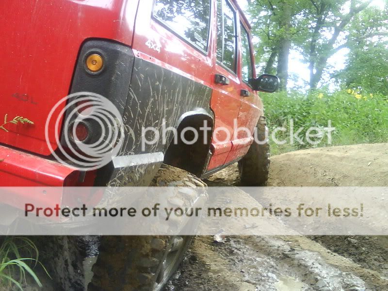

i know this sounds pretty gay but it worked pretty good in my 98 cherokee
i broke a few tail lights, so i got another set drilled some holes in them for led's put them in and then put expanding foam inside the light then truckbed lined the outside....i never broke them again
Tailight fillers and LED's
@86- So you just drilled the necessary size holes into the regular tail light and bed lined over it? Looks good!
yup and filled it with foam to make it a little stronger, though im sure a good enough hit would have broke them but much better then stock
slo-vo, that's actually a really good idea with the spray foam, it will add lots of rigidity on the inside, so the pushing won't crack it, as it won't make the lens flex much, all you would have to worry about is sharp impact, but the bed liner should absorb most of that...

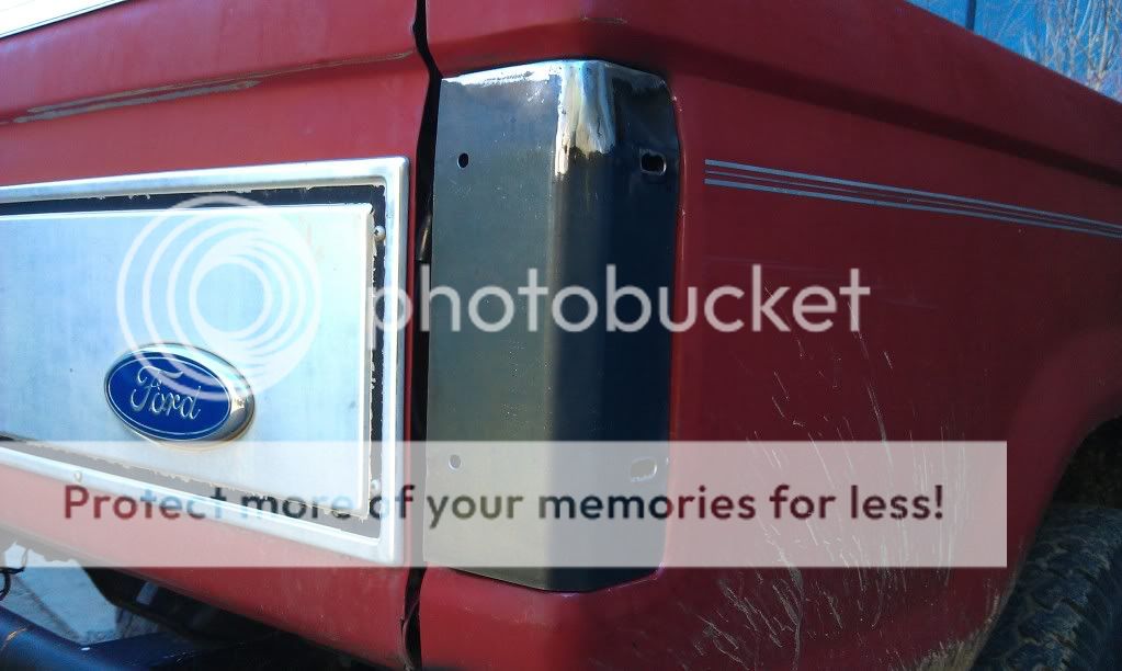

Started working on these today. Here's what I got so far.
Put some lights in tomorrow and check em out.
lookin good, did you hand form those? they look like they fit the lines pretty well, cant wait to see them finished and in paint!
The main plate just has two 45 degree bends in it. The top part where the compound bend is required taking a pie cut and rewelding it together. Fits up pretty good for just a rough copy. It's 11ga which is almost 1/8" thick. Gonna get lights tomorrow and fit them.
