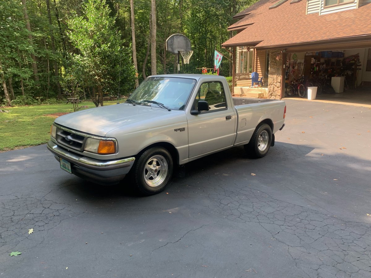

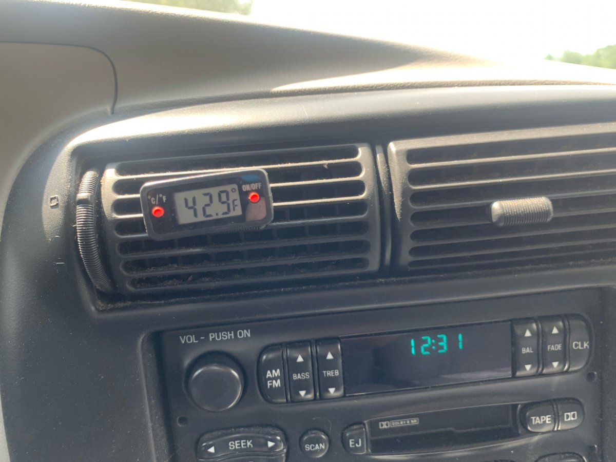

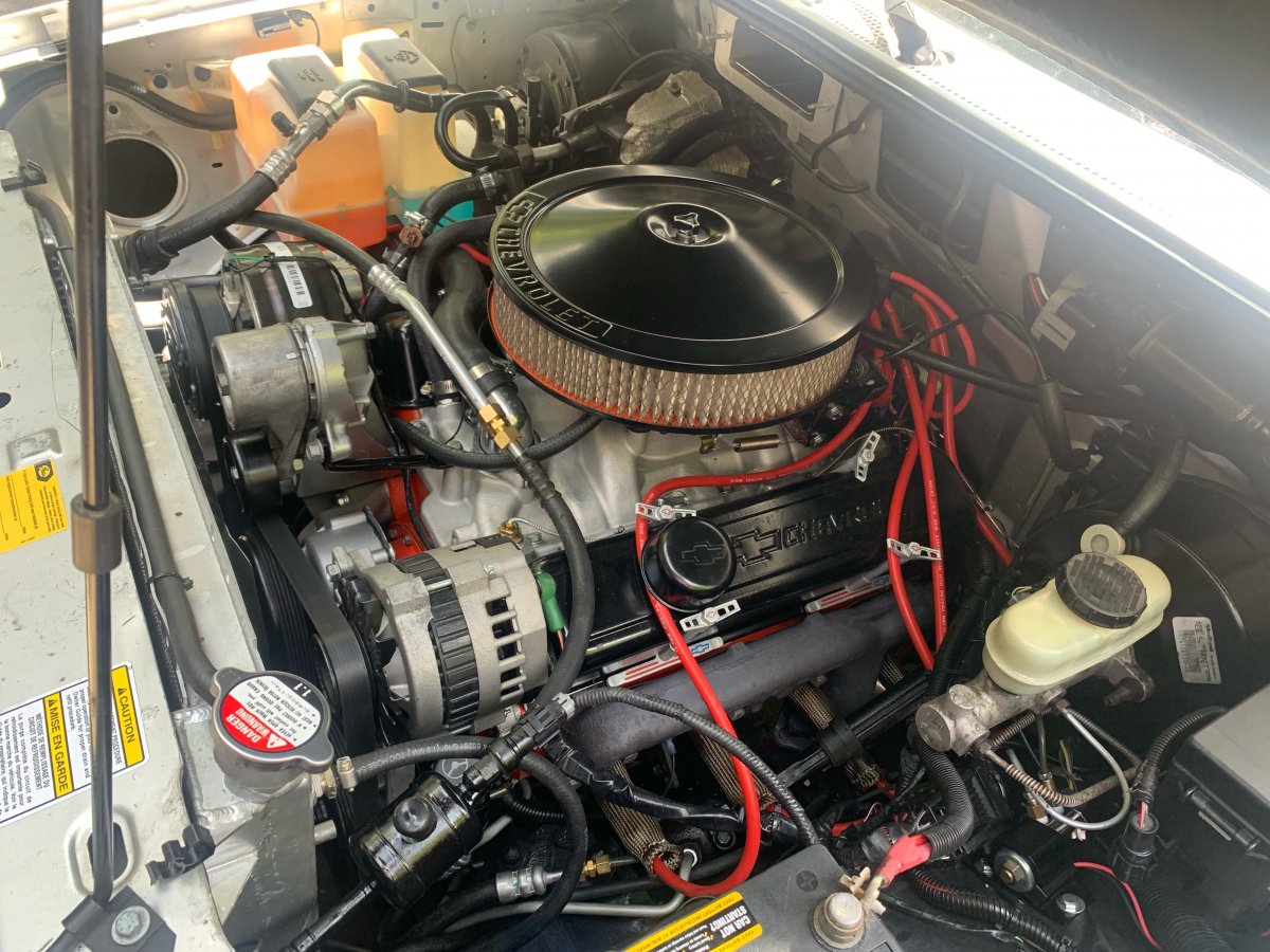

about a six month 350 chevy engine swap in a 1997 ford ranger. for the people that said the p/s and a/c wouldn't work. i say go back to school. chevy p/s pump with ford gear box. chevy a/c compressor adapted to a ford system. all gauges work even speedo but that is another story. turbo 350 trans with 8.8 lsd rear with new bearings and clutches. i had put ford mustang wheels on it but they just didn't look right to me. i bought a set of weld wheels and tires and i think they do it for me.

i haven't posted for a while because i didn't want to put my foot in my mouth about the a/c and p/s. runs good, looks good, and pretty fast.

What are you doing for a cooling fan - is there a pusher tucked up front?
there is a flex fan on front of engine but it wasn't running cool enough for me so i put a 17" pusher fan in it also.
I'm not surprised you could use the GM p/s pump and compressor. As long as the p/s pressure is close to the same it will steer fine, in fact, a lot of the street rods guys use Mustang or T Bird racks with Saginaw pumps. 71-73 Mustangs used Saginaw pumps and 70's LTD's and T Birds used GM swash plate a/c compressors. You did a nice professional looking install of my least favorite engine.

they are weld pro star rims. i had the original 14" on there but i wanted wider wheels and tires. even with the wider wheels traction is very low.
I know the feeling. I have 12.5 rims on the back of my 04 Lightning, with 345/35-18 M & H Racemasters on them. Even with a set of long bars under the truck, still spins them if I mash the pedal at a standstill.
