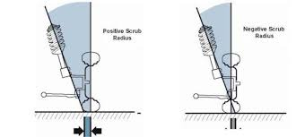

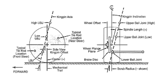

The other thing you want to watch is kingpin inclination angle and its effect on scrub radius. By installing tires a couple inches taller than stock, you reduce any positive scrub radius, possibly making it negative - which impacts how your truck steers.
A wheel with very small scrub radius simply twists when you turn the steering wheel. With a large scrub radius, the rack and pinion must force the wheel to rotate back or forth - which is harder on steering components.
The simple solution is to space the tire out further (which is why aftermarket rims usually have smaller backspacing - they assume you are going install taller tires).
The taller tire also messes with the mechanical trail (but more trail with larger tires is usually a good thing).
