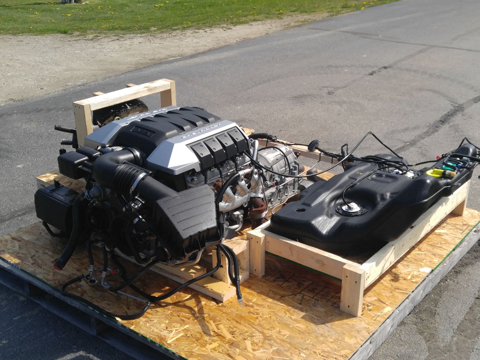

Hi BobbyWalter, Its a good thing the motor picture doesn't show a location, it's so pretty I would have come by and pilfered it overnight. It looks kinda wide and long to stuff into a Ranger. I'll recheck the 5.0 info. A5.0L really wasn't on my radar, but it makes sense to increase the power with one engine vs modifying a 4.0. I may have to pick your brain at some point.
