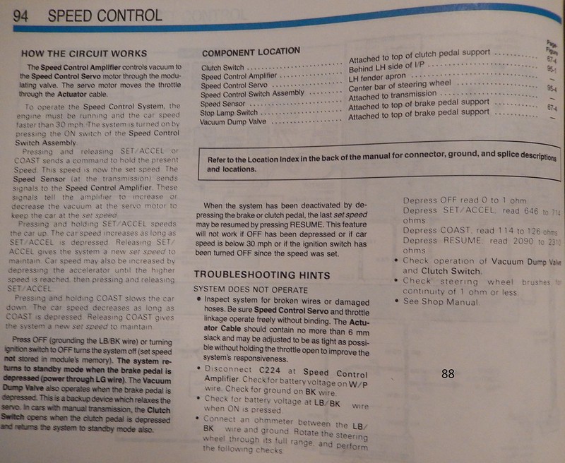

It isn't a super easy thing but to me it wasn't too bad. From what I remember the main power plugs into the back of the fuse panel. You need the harness that runs between the servo and the amplifier (module) and the harness that goes to the steering wheel and of course the horn pad with buttons. You need to run wires down to a speed sensor on the trans/t-case and tap into the brake signal on the outside of the firewall. Install a vacuum switch on the pedals. And run all the vacuum lines (plain tubing)
Servo bracket and vacuum switch bracket are the hardest to acquire. One is riveted in and one is buried in the dash on top the pedal bracket.
A taste of what needs done:
If you go this route and need any help let me know. I have a lot of diagrams, connector pinouts and troubleshooting stuff and my truck is sitting in the garage if you need pics.

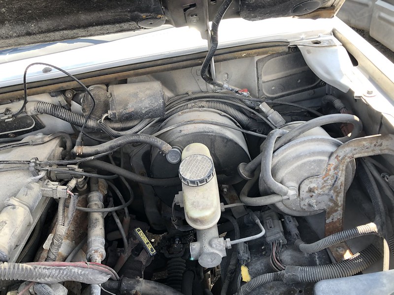

Factory install on a 2.9 Ranger:

The round thing on the DS in the picture is the servo. It is like a big vacuum piston that moves the throttle cable.
I was thinking it would be smaller, but it is an 80's servo lol
