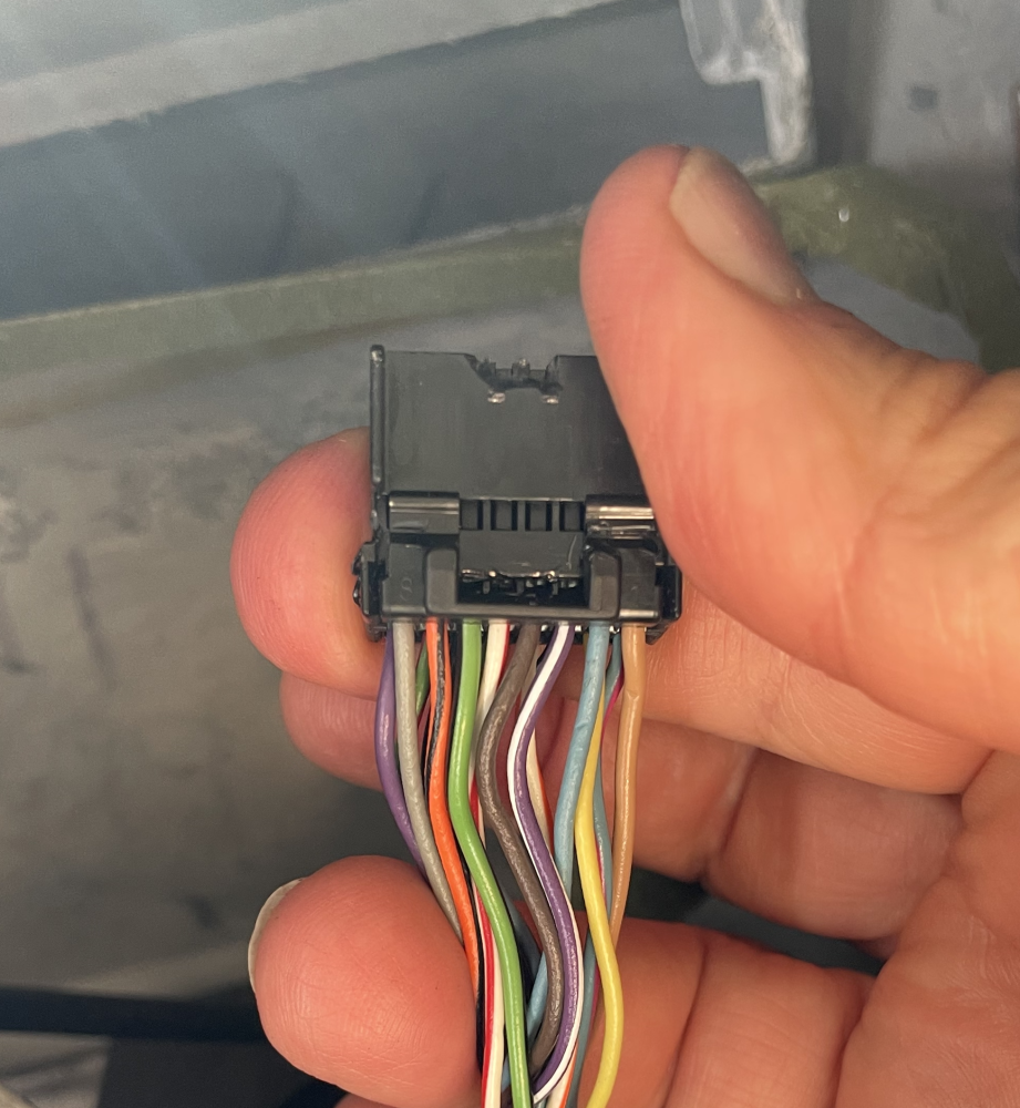

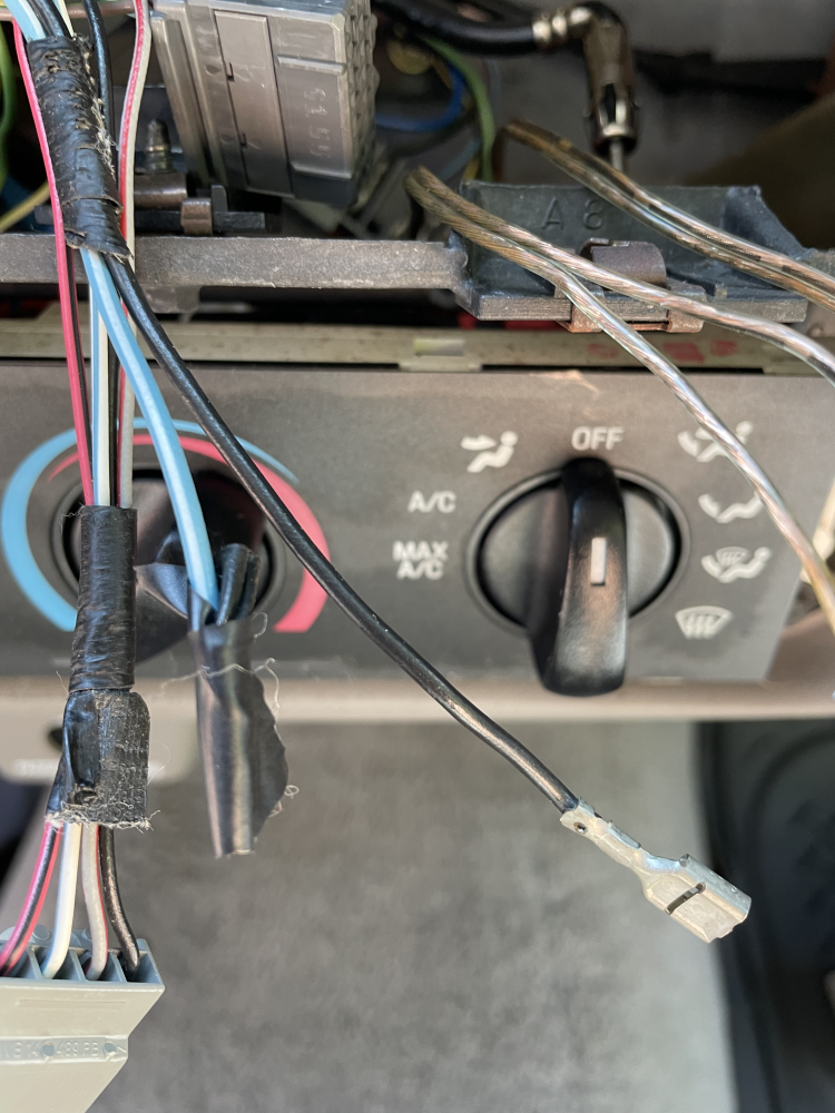

Update. I found fuse 25 blown, and it popped immediately when I installed a new fuse. I disconnected the connectors to the GEM and now a new fuse does not pop. so I ordered a replacement (used) GEM with the same part number. Nothing obvious on the GEM board when I opened it, so fingers crossed. While I was into the dash console I noticed a few extra wires just hanging out. One is a black connector with lots of wires. Anyone know what that is for? 4WD? (Mine is a 2WD truck). My cigar lighter connector is also missing off the blue/white wire. Anyone know where to find one of those?

junkyard?
maybe the local auto parts place has the cigarette stuff though?
the black plug, no idea here
