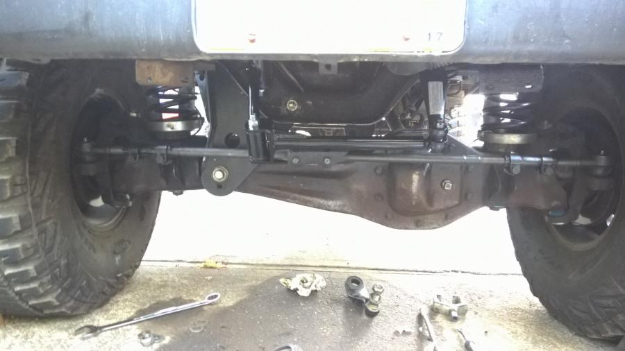

Hi guys, I just installed my superunner steering kit and it looks decently flat with no modifications done. After reading 4x4 junkies write up on how the angles of the steering needs to be in phase with the axle beams I noticed something looks off. It almost looks like I don't have enough lift for the skyjacker brackets. Compared to others I seen it looks like the steering sits right in front of the drop bracket bolts. Any idea why mines not and if it will make my steering wacky? Thanks!

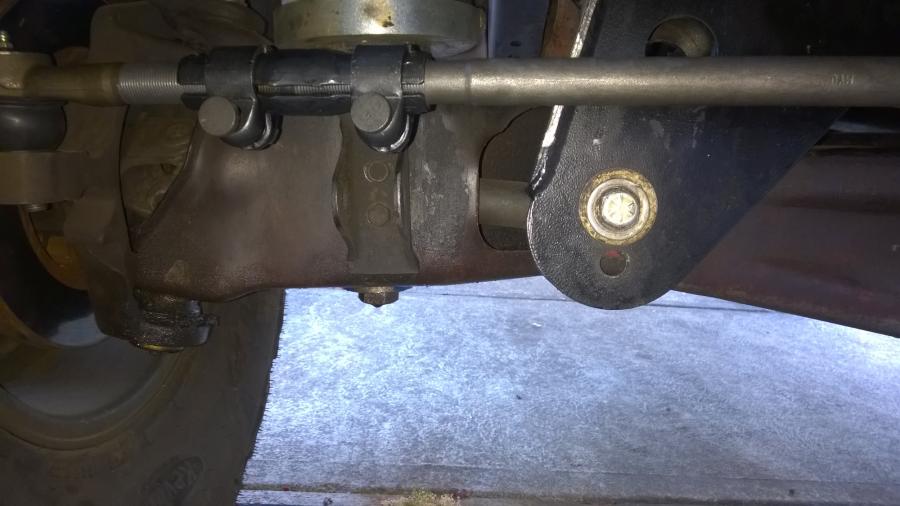

Another pic

Indeed your suspension's ride height is sitting lower than it should be (coils not providing enough lift for your brackets).
See this article (bottom half of page, under "DIY"):
http://www.therangerstation.com/Magazine/winter2008/steering_tech.htm

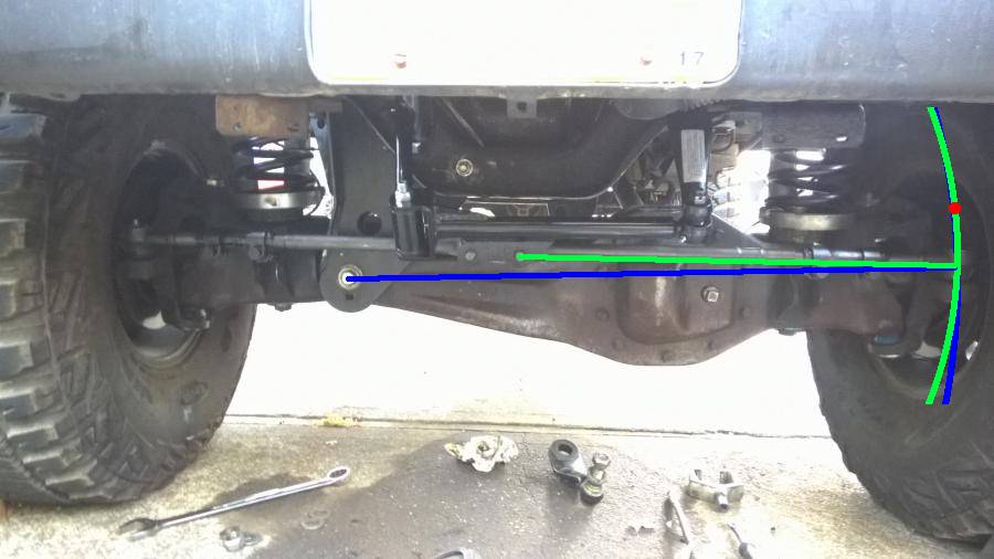

That steering is definitely not in phase with the suspension, and will become more out of phase after you raise the ride height (your tie rods need to be inline (parallel) with a straight line between the beam pivot to the TRE at the knuckle with the truck sitting at normal ride height). My estimate is your centerlink will need to be dropped down about 1.75 - 2 inches.
Looking here, you can see the point where both your tierod and the suspension (axle) are in-phase (red dot) is way above your tie rod's connection point to the knuckle. Lowering the centerlink would bring that point down so that it sits right atop where your tierod is at static ride height (minimum amount of bumpsteer).

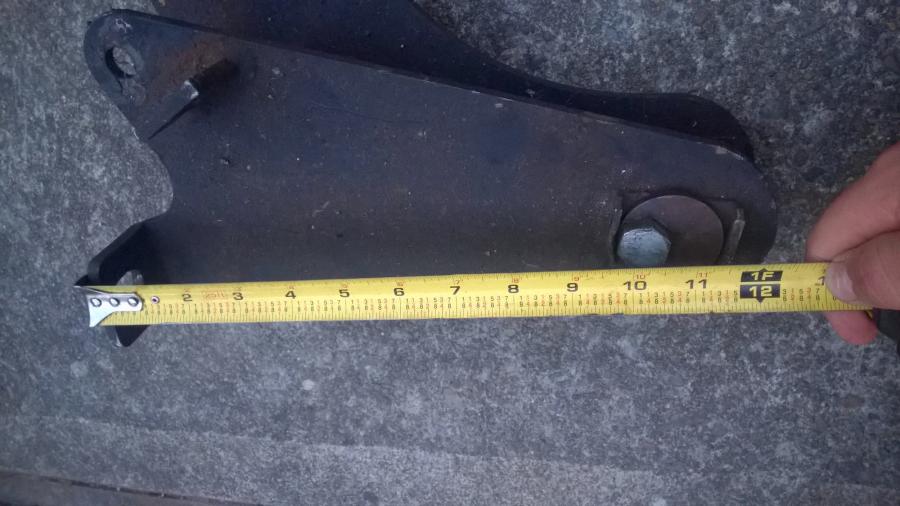

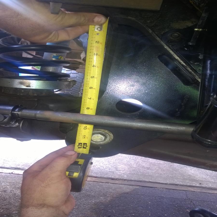

They advertise them to be used with a 4 inch lift. And the skyjacker can be used with a 4 inch as well from what I was reading. I measured both different brand of brackets and i found some interesting info. This explains why my ride height is so different with the same coils and different brackets.
The skyjacker bracket is quite a bit bigger for some reason.. Its has about an inch more drop.

Looks like if you rotated the built-in camber adjuster on the TC bracket 180° it would then about match with that of the SJ bracket (and is probably how TC specs theirs for 4" lift). The way you have it positioned makes it effectively a 3" lift bracket.

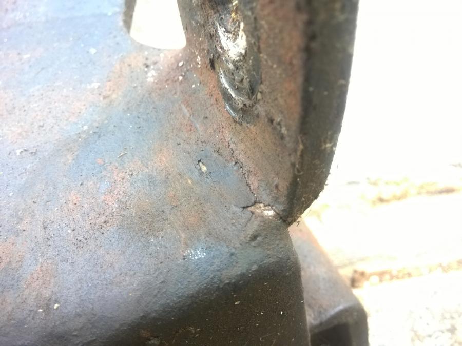

Also I had saved these of someone's busted Superlift bracket (I forget who... BloodBane maybe?)
the only ones i have not fawked up were the ones joel made me....
this is in stock form...beefed brackets usually work fine.
