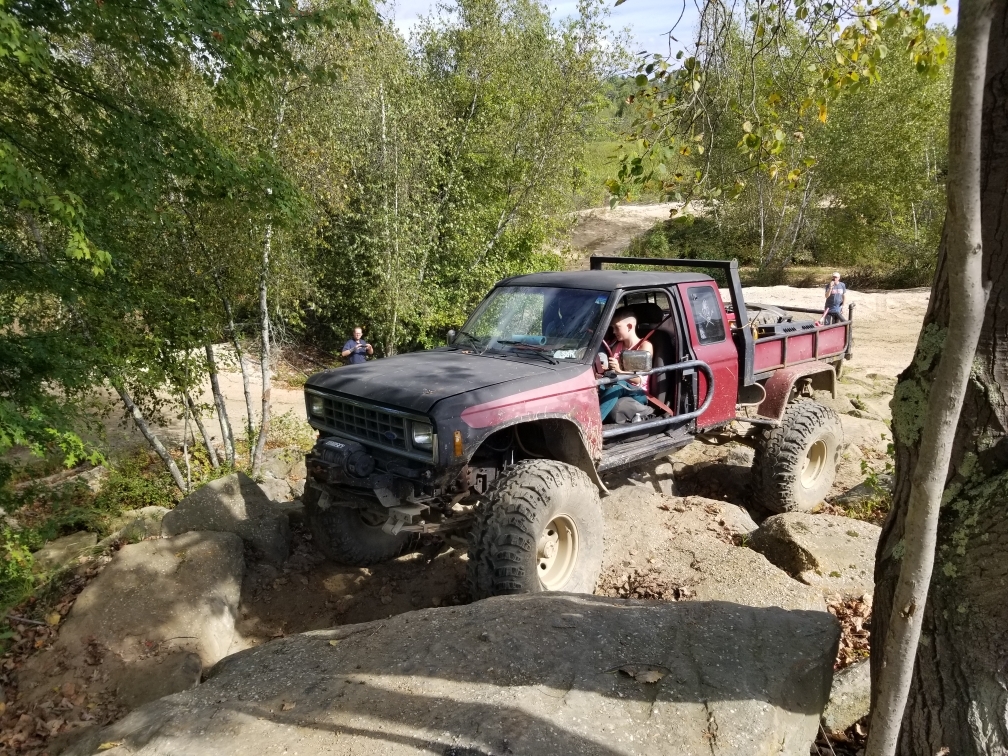

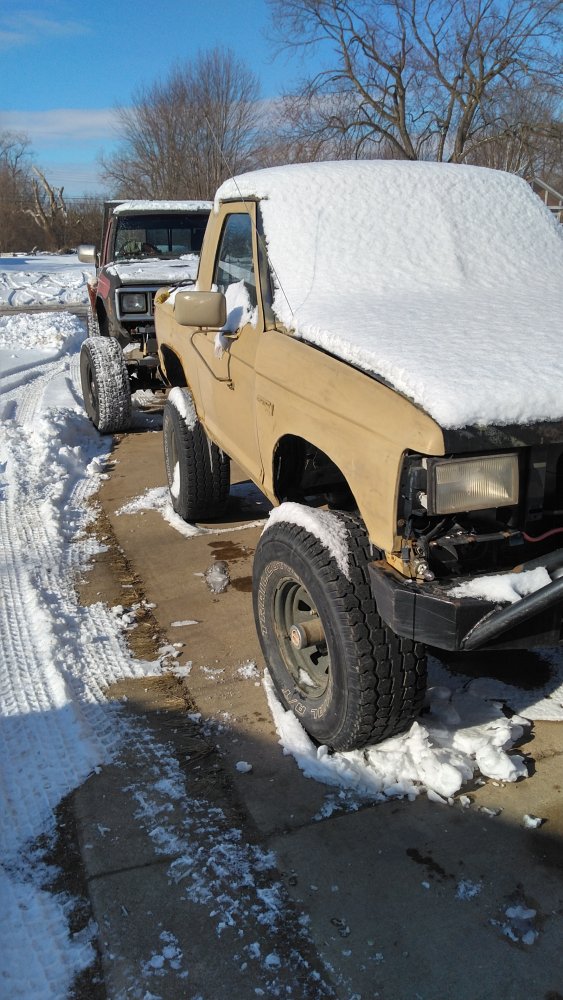

The ranger is on 79 snofighter 60,s
Bronco 74 be 44
Sweet rigs.
