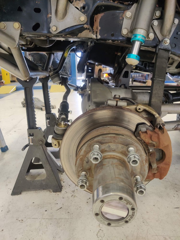

So is that a Dana 35 with Dana 44 knuckles and hubs? What size BFG's are you using? What gear ratio is in the axles? Did you custom build your own TTB drop brackets?

Hey thanks, and yeah that's the front hub hybrid setup, 33 x 12.5's right now, 4.10's with a truetrack in the rear. Beam brackets I modeled 1.5" of drop which is pretty close to rangito stx geo, couldn't find a set in the yards around here.

Went and yanked a fomoco box from the yard a few weeks back, did a flush and seal job on it along with all new all moog steering. This is now the 3rd steering box for this truck, box 2 (some autozone garbage) felt bad after 1 trip and was leaking all over the rig. Front coilovers also got a quick check up, was paranoid I bent the drivers side shaft but it cycled by hand perfect. Been Daily driving this thing for a while now, the m5od feels killer, also took all the lead weights off the wheels after adding balance beads inside, pretty significant increase in comfort, highly recommended.
Made it a point to use the best parts fomoco put out for rangers and explorers for this build.
