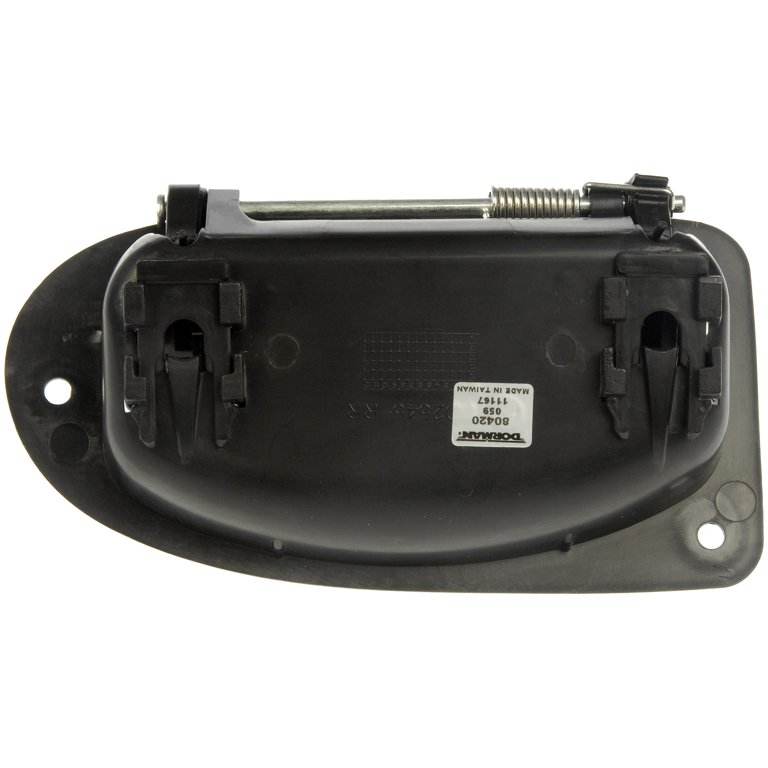

Here's a picture of the back side of the handle. When removing and installing the cable you need to release those clips. If you try to force the cables back through you are likely to break the clips and/or the plastic holding the clips. That's exactly what happened on mine. I can't say that you won't get lucky and pop them back in without breaking, but if it breaks you've got to remove it to replace anyway and you're out time and money getting a new handle.
