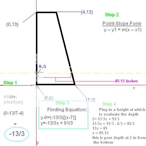

worked out the equation of my box (yes i am actually using math outside of school... WOW) and i'll post up how I did it here in a bit.. could possibly be stickied, or on the tech articles to figure out depth of a wedge box. i feel like it was pretty clever!
if you want text directions, let me know... it's very simple, and i have no clue how i didn't think of it sooner!

oh and nice math work by the way. I was always the kid saying why do we need to learn this? Im never gonna use it.
I think i would have just cut out some cardboard though.

Depths:
at 2 inches : depth of 6.538 inches
at 3.25 inches: depth of 6.25 inches
at 6.5 inches: depth of 5.5 inches
at 9.75 inches: depth of 4.75 inches
at 11 inches: depth of 4.46 inches
what is like an average magnet diameter?
considering the middle of the magnet will be at 6.5 inches high (centered), the depth is only 5.5 inches, if i did my math right(which it's fitting a reasonable answer, the higher up i go the smaller the depth is)

well if the diameter is 6 inches, this makes the radius half of that, 3. and 3 inches (so about top of the magnet) is going to be situated at 9.5inches high, and I have 4.8 inches of depth at that height. so that means that preferably the mounting depth would be about 4.5 inches i suppose.. or smaller.

the cvt would fit then.... 4 5/16 ~ 4.3 inches, and if there is a 6 inch diameter magnet, it will fit and still have half an inch at the top (the narrowest part), even if it had a 9 inch magnet, it would still fit... is this a good idea for a sub??

MAX MAX MAX dimensions of box at 52" wide, 13" tall, 8" deep on bottom, 5 inches deep on top
but those depths are pushin it, as I will need space for flex!

just realized all the measurements i used on my "math" were exterior dimensions.
so i suppose i'd have to take off 1.5" of each one to find the interior? i am using 3/4" mdf... think i could do 1/2"? or should i stick with 3/4"?
