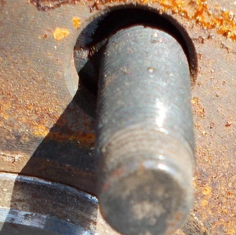

stud holes!
al lafon
Oct 7, 2012
9
No not them! But my disk rotor holes
seem to be to big? Is this ok?:sad:
The rotor is hub-centric, not lug centric, meaning that the hub centers the rotor, the pressure of the lug nuts on the wheel holds it in place, and the lug holes are really only there so the lug nuts can be put on.
