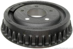

9" brake drum here: https://www.ranger-forums.com/attac...rake-drum-size-9651-4.jpg?dateline=1346709884

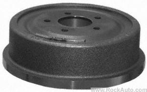

10" here: https://www.ranger-forums.com/attac...ake-drum-size-18-9498.jpg?dateline=1346709884
Obvious difference, 9" has fins, 10" is smooth, so have a look at what you have now
