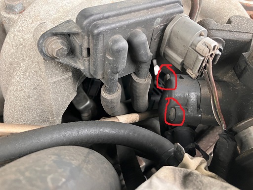

Holy BLOCKED tool-path Batman! Ain't no gettin' to those 2 TPS screws, esp. the rear one... even if I remove the DPFE sensor, the intake manifold is in the way of even the stubbiest of screwdrivers...
... looks like the entire throttle-body has to come out?... and even then, it doesn't look like there's ANY adjustment/slotted-design to the 2 (not 3) mounting holes, nor does there appear to be enough "meat" there to enlarge the holes... can I shim it INternally? Or after all that disassembly hassle, will a NEW TPS do the trick?

Which one are you trying to get to? and have you seen the price of zip ties?!
I marked the 2 screws in question... BUT basically it's a matter of I've picked up a few extra ohms in my wiring... a blast of contact-cleaner in the plug?... is there a trim-potentiometer near the ECU?... :cool:
Pull off the DPFE sensor and you can loosen the screws, see if there is movement in the right direction, i.e. key on check TPS %

I'll have to find my super-stubby #2 Phillips, and the weird Craftsman slip-joint pliers w/ rubber "condoms" on the jaws to turn it... :cautious: ... still rather just tweak a trim-pot, while eyeing my voltmeter... :geek:
Problem is..................your are voltage shy, only getting 4.3volts and need 4.5volts at WOT, so can't "trim" that with resistor
