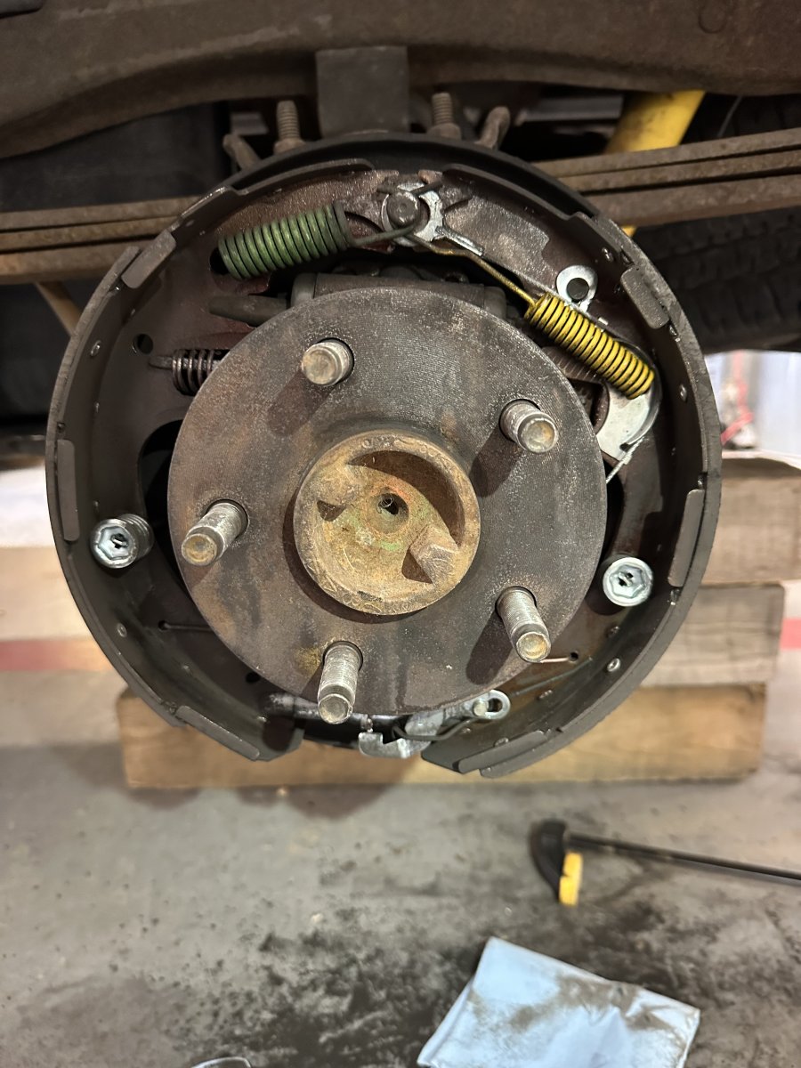

Success! I got the drum off. And a LOT of brake dust came out of that drum. Now that I have it off, everything looks pretty normal inside. No broken or missing springs, no leaking brake fluid, the only strange thing was the absurd amount of brake dust compared to the other side.
Thats because the brakes have been dragging.
Take a picture so we can see what it looks like...
Most of the pads have .180 remaining, some are at .240 and one is at .150 at one end. Pretty inconsistent wear, maybe the star wheel was adjusted wrong from the get-go? Or is inconsistent wear from end to end typical?
The drum pictured is the offending side.

Was there any axle grease or brake fluid leaking on the other side? Something that would act as a lubricant and let that side slide, while the one you’re looking at was locking up?
Go back to basics. With the drums off, use a pair of channel locks or something like that to pull on the emergency brake cable. Is it moving back-and-forth? It should. Press down on the emergency brake and see what it looks like, side vs side.
Look at the teeth on the star wheels. are they rounded off? First and foremost, are those star wheel gizmo’s installed in the correct direction. You can put them in backwards, and that’s a problem.
Look at the teeth on the star wheel, is the wear and tear on the left side, the same as the right side?
Look at the adjustment arm that engages that star wheel. Is one side worn down and the other side sharp??
These guys will jump on me, I’m the one who rigs everything, but the cross-section of that lever should be rectangular at 90°. If one is worn, and the other one is sharp, they won’t adjust the same. Here’s where the other guys will jump. If you take a file, or go very easily with a grinding wheel, you can restore the rectangular profile, 90° corners. You want both of those star wheels and adjustment levers to work the same way.

I looked at your picture... nothing stands out being incorrect. But the point where the shoes meet the anchor pin... look closely at the shoes... when that brake assembly is at rest... the shoes should be fully seated against the pin. If they're not... the park brake is hanging up holding the shoes in a somewhat applied state.
