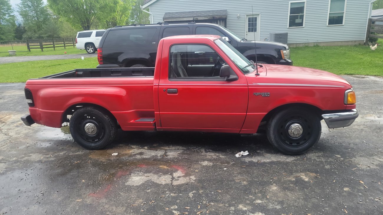

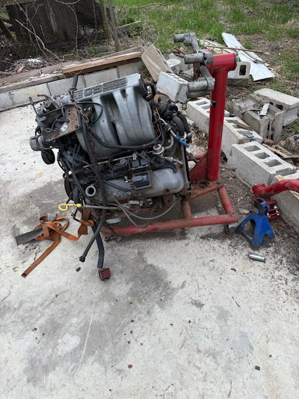

So I have been working on getting ready for a 5.0 swap in my 96 ranger 2.3, manual 2wd.
I find there is a lot of conflating information about manual transmissions...hoping to get a straight reliable answer....
Ranger is 96 2.3 r1
Engine for swap is a 94 f150 5.0 that is getting holley sniper for engine mgmt and timing.
What r2 will mate up with that combo and have a good location for the shifter? I hear 97-2003 but I want to make sure.
Lastly, is there an 8.8 that is 100 percent bolt in for this truck...4.0 ranger..something else...?
