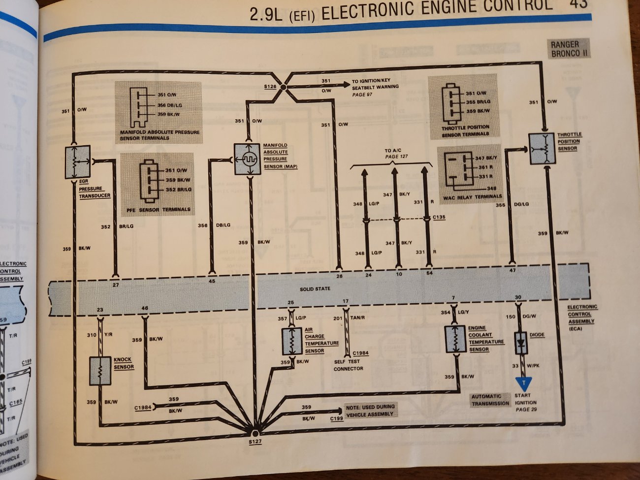

You will have to trace it out and see where it goes. Lots of green wires under there. You said you had the harness tape off.
I think i answered my own question.
I found a wiring diagram and i *think* its a tachometer wire. It did appear it was never attached to anything...which would make sense cause i dont have a tach

I have an 86 EVTM...
You want a diagram from it?
if you can post it, the only ones i found were 87\88 but i figured they were the same

Yes it has a knock sensor but im running an 88 ecm.
You are correct. The 86 has the sensor hooked to a yellow/red wire and going to pin 23 on the computer. 1988 does not have a pin 23 in the diagrams. And of course no knock sensor hooked to it.

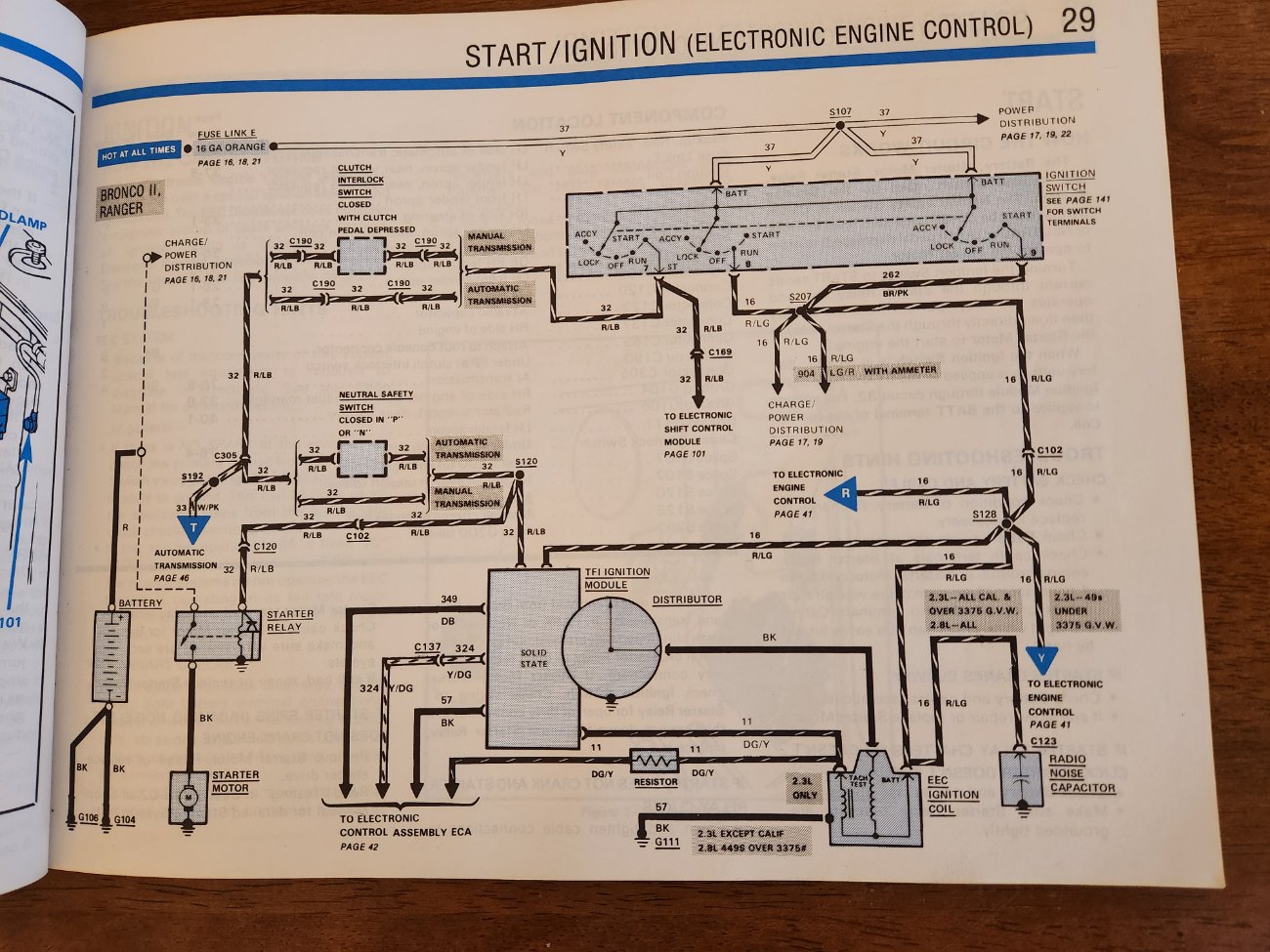

There what I got... forgot to do it yesterday Rusty.

The harness diagram is what I seem to have for a 1986 Ford Ranger/BII. It is very very difficult to read when you want to logically follow a circuit. It's priority are the wiring grouping and the harness plugs. It's a very large fold out system of diagrams. Not very good for troubleshooting.
