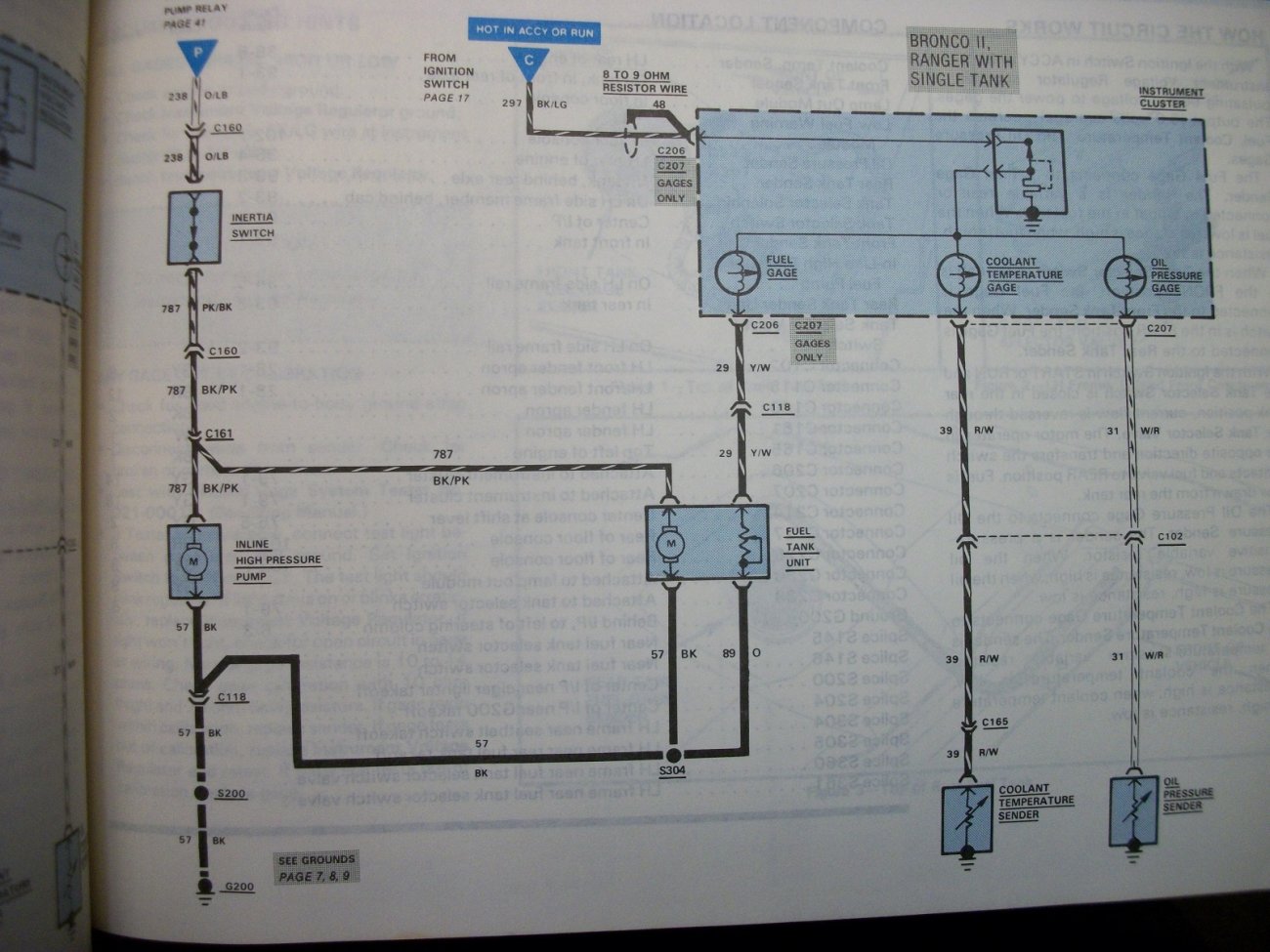

I already had this 1987 page imaged and on file:

For the fuel sender… probably, but you never know with Ford. My green Ranger has a ground wire in the rear harness that I know is the ground and is in the proper place and connected to the proper things… but doesn’t match the color that it’s supposed to be according to my 2000 EVTM…

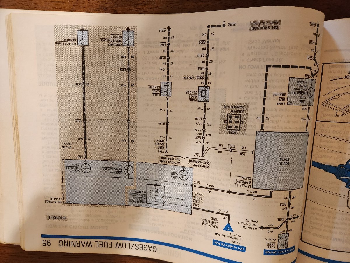

The '86 covers with lamp out and low fuel warning; and without. I don't see that in the '87 book.
@Uncle Gump posted the '86 schematic.
I wanna try to get my gauge working properly or close to it.
The page after the schematic may help, then, especially the operation description and locations of connectors and splices. I think that you've already found bad splices elsewhere, so you know the drill . . .
