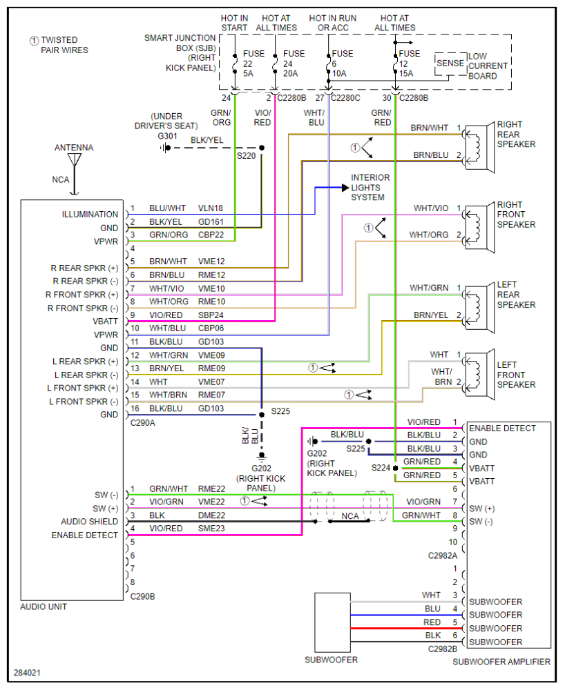

Good morning all, I am in the process of installing sound deadening, new speakers, and a small sub and amp. I finished everything, reinstalled all of the trim etc... Speakers work great, the Amplifier turns on, but my Subwoofer isn't getting any signals. I was using a Line Output Converter to keep my stock stereo (Required me to Tap into L+, L-, R+, R-, and Ground...) , but my thought is that I tapped into the wrong wires. All of the diagrams on the internet are either not for my truck or behind paywalls. Does anybody have a diagram for the Stereo Wiring Harness for a 2010 Ford Ranger XLT on this forum? Any help would be appreciated, thanks.
Here is the diagram I referenced during my install:
I tapped into R Front +, R Front -, L Front +, L Front -, Ground, and VPWR.

Well, thanks for the reply, I fixed it. All I had to do was unplug and plug it (speaker wire to the subwoofer) back in again 😒
