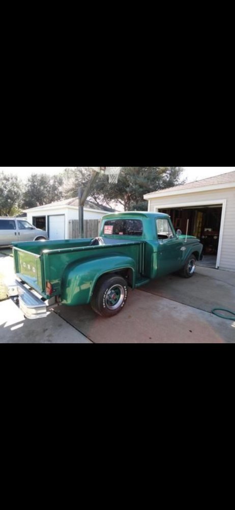

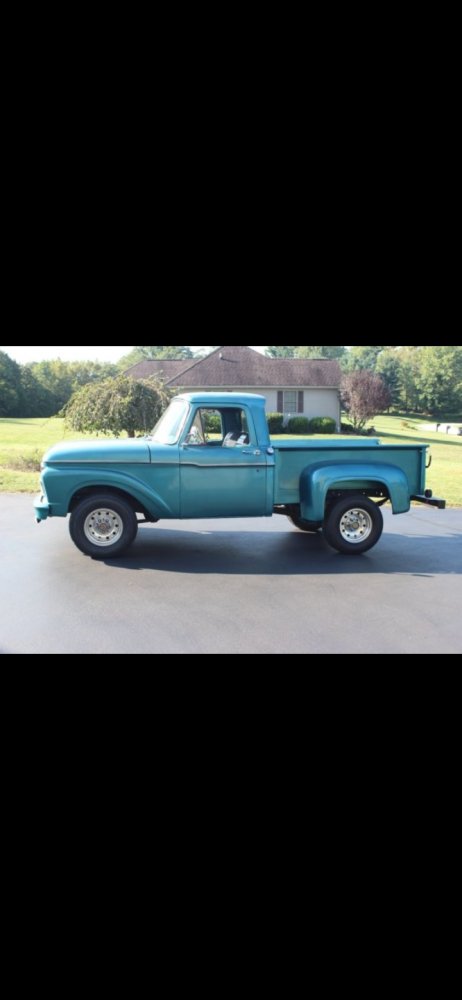

Are you talking about the shadowbox style?
41910
Yes, like one of these beds on a Ranger

A guy over at InfamousNissan.com used one of those beds on his hard body. I didn't like it but it turned out ok
41933
He has since painted it lime green with black accents. You'll notice the 5 lug swap and I believe it also has an LS motor swap
