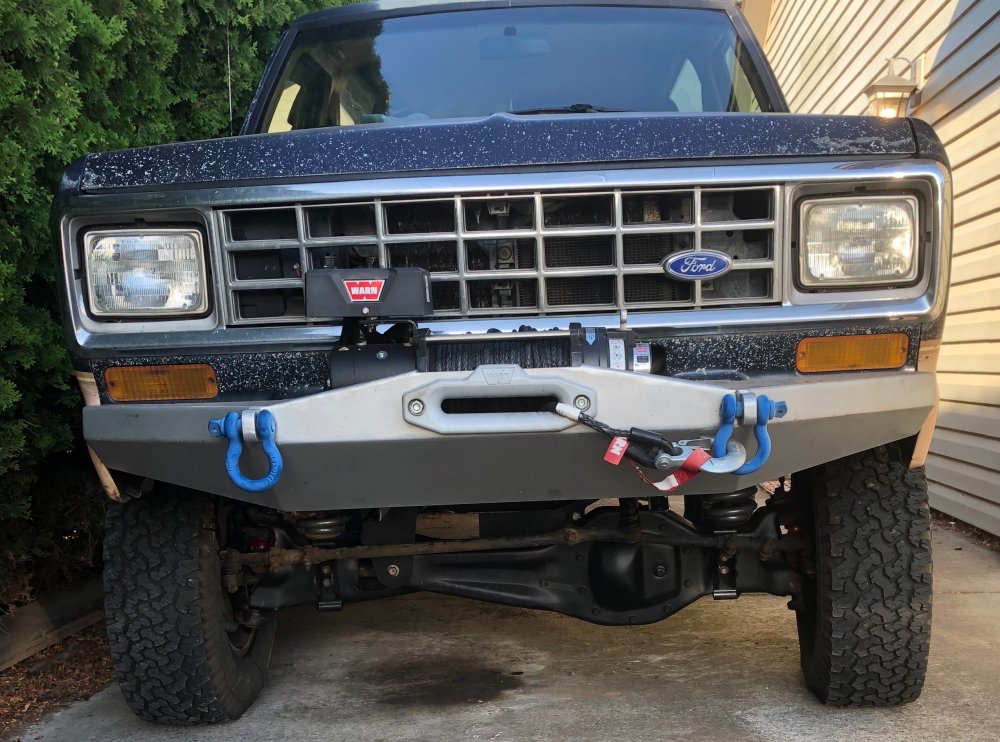

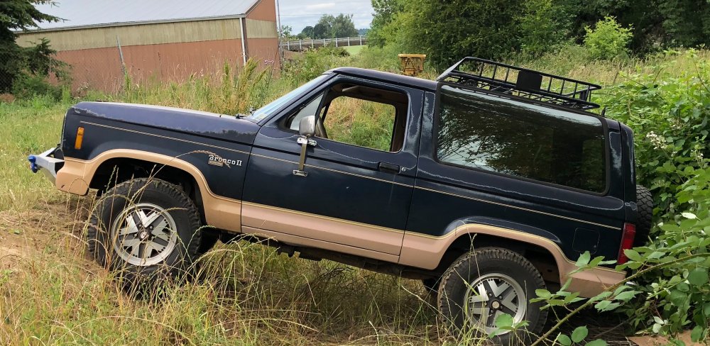

I just lifted my Bronco with a rough Country 4” with James Duff radius arms. Well I got it back and now I need to address the problems. First is the shocks, the ones that came with it are too short. That should be easy enough. The toe in should be fixed with new steering arms. Camber is the one that I’m not sure of. Moog make a model k10809 which will go plus or minus 4*. Is there a disadvantage to this one to fix the camber or should I use something else. I would like to get it close before I take it to the alignment shop. Any advice would be appreciated. Thanks.
