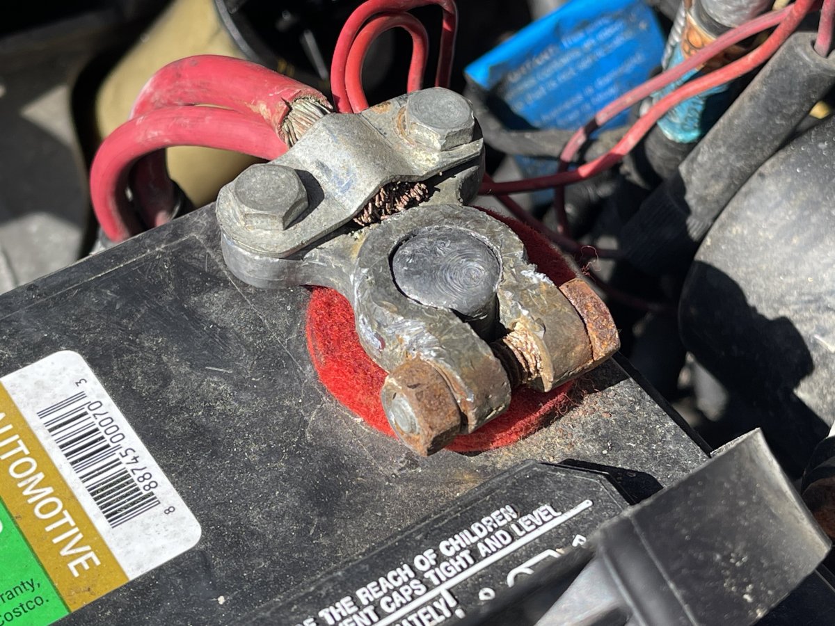

And Bingo was his name-o. It was corrosion at the positive battery post. The previous owner ran a few extra circuits for lights and accessories. The clamp holding the extra cables had allowed some corrosion. So while the battery clamp was tight, the corrosion at the wire ends was preventing the required start current to flow.
We're good now. Thanks everyone.
Doesn't take much. I was having said issue. It was the two bolts holding the clamp together were loose. Tightened them up, bingo.
I've seen this happen many times with that style of replacement terminal. I prefer to replace the entire cable with one having a pre-attached terminal when practical (and when not, then a pre-made cable cut to length and soldered to the existing cable(s) then shrink-wrapped).
