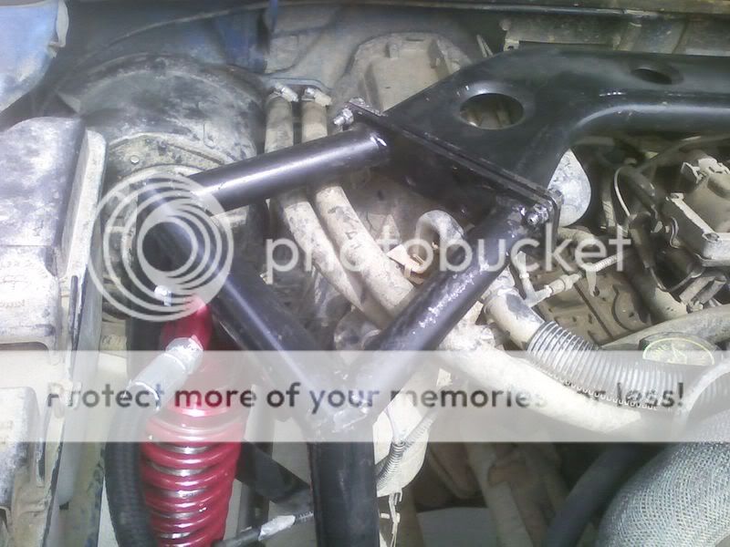

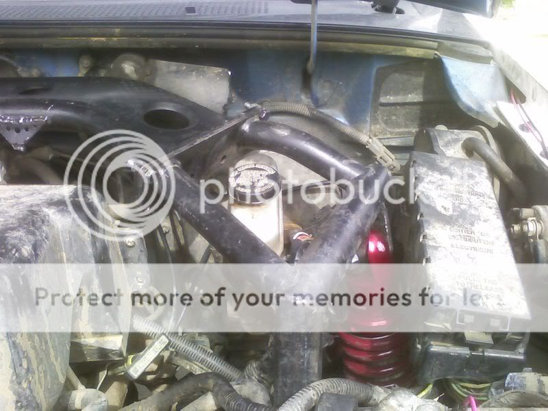

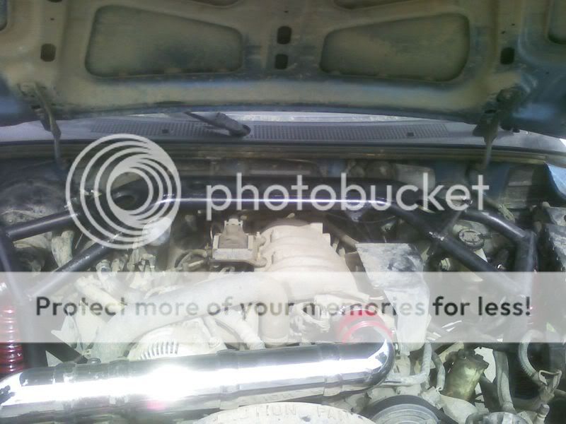

heres the pics of the engine cage for ya 84
driver side
passenger
and overall
it was pretty tight on the driver side with the brake master cylinder and the fuse box. on the passenger side i had to relocate the intake tube and just did a cone filter on the end instead of reuse the old air box. besides that its a pretty nice fit.
