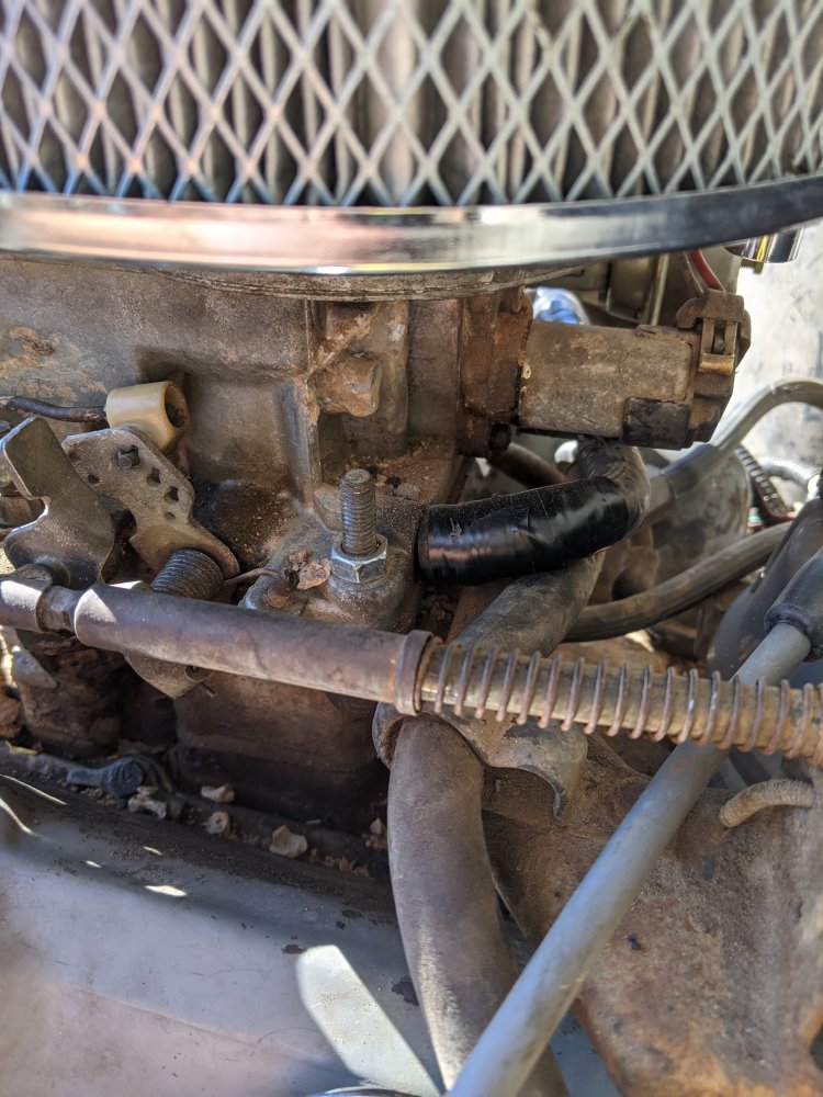

I can't find a port that's open. Hoses look "wrong" I think because of the emissions delete done by previous owner. Where should the port be? Also, can't find any hose running to the distributor? Although I admit I'm new to carburetors and vacuum systems. Attached comes out of carb and goes back to the same area? Today I can accelerate but it still hesitates and backfires, just doesn't die.

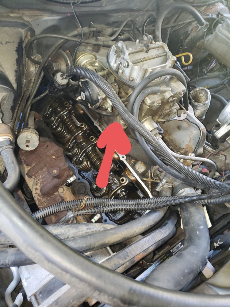

Is that supposed to be underneath the cap? It's hooked to a port on the back driver's side.
This is where it is attached. All of this is as I got it, no idea if any is right.

On my 2.8, the vacuum advance is hooked to a different place, passenger side right under the choke. It could be the port its in now only supplies constant vacuum, but you need vacuum to increase with throttle. I might also be running a different carb, check your schematic.
