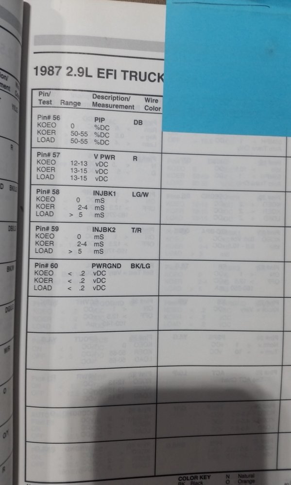

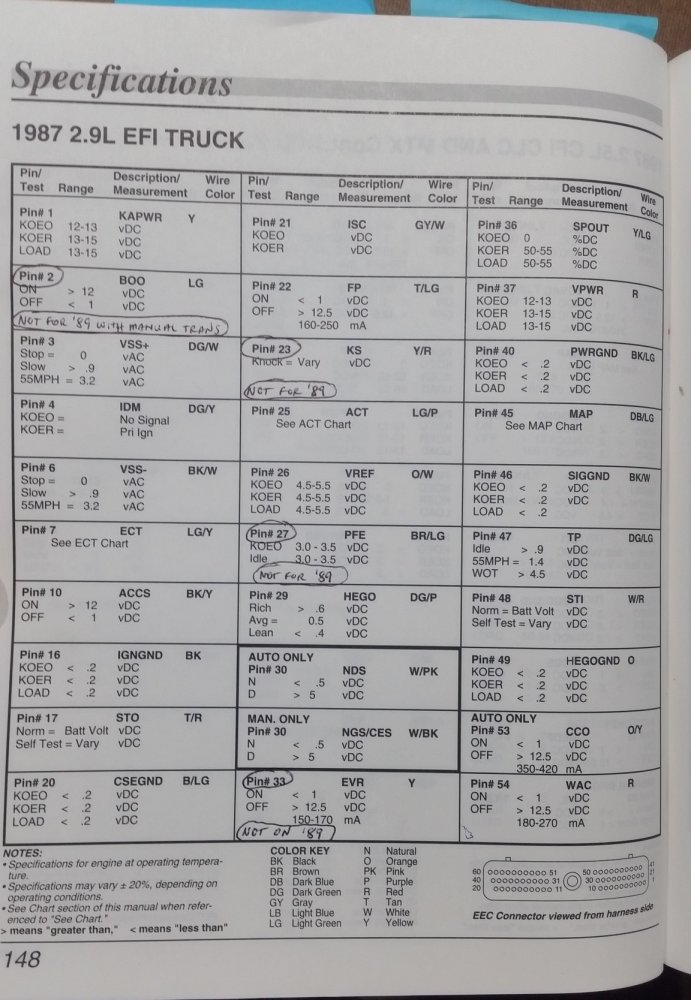

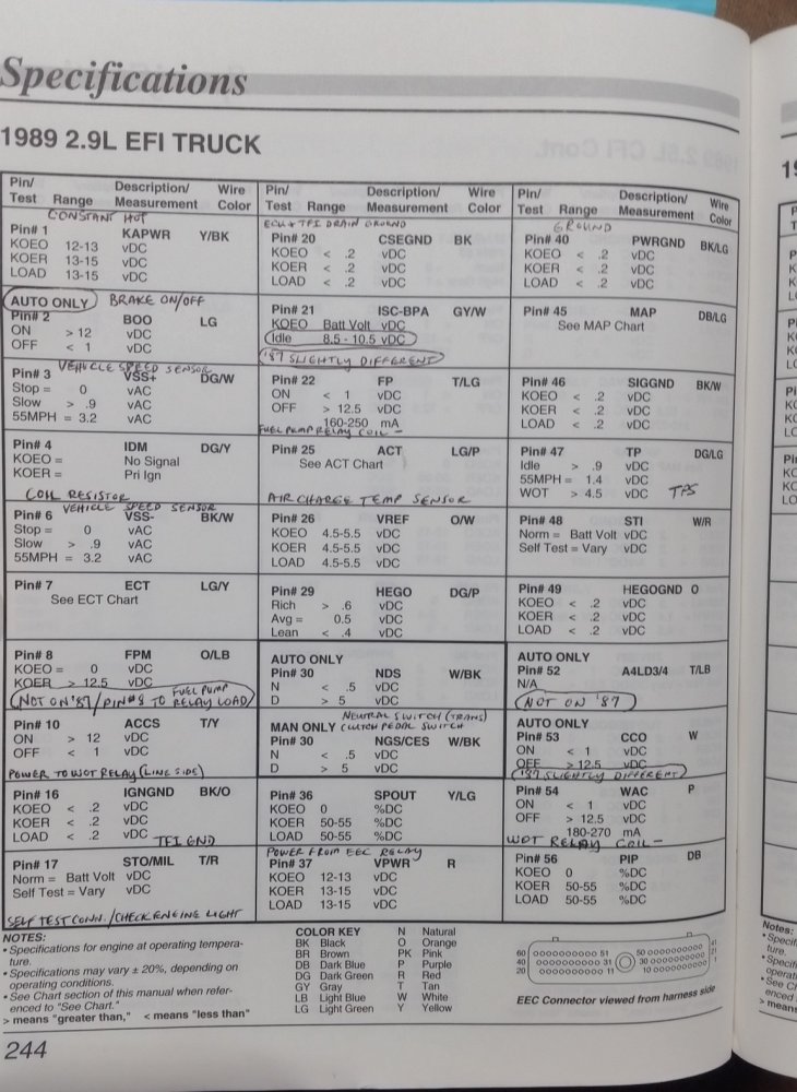

I think the fuel issue you mentioned was a post I made about my engine stalling while I had the fuel pressure gauge hooked up and I noticed the fuel dropped to 0 in about 5 seconds. RonD replied "If your engine is stalling with key on then when RPMs drop low the computer WILL shut off the relay, but injectors stay on, so pressure will drop as engine stalls out." Every time I do a fuel pressure test the numbers seem great so I've kind of moved away from investigating that system. When I first got the truck I was pretty sure it had a fuel issue and I posted on here about it but I ended up taking it to a mechanic and they figured out it was the ignition switch contacts going bad. If the truck hit a bump in a certain way it would just turn the truck off and sometimes it wouldn't start up. So far fuel delivery hasn't actually been a problem for this truck as far as I can tell.
No trouble codes. When I put the new computer in I finally got one which I got really excited about. It was for the PIP sensor and thats what lead me to replace the distributor. Unfortunately my surging problems didnt go away but I havent seen the PIP sensor trouble code again. I did check/set the timing with the engine warm when I installed the distributor. The spout connector was out when I set the timing of course and the timing appeared steady and consistent when I was setting it. The SPOUT connector has been in ever since.
You know I really thought I had it in the bag at one point when I started looking at the alternator, I was thinking maybe the diodes were going bad and it was putting AC current through the truck but as I did more testing I couldn't actually find any issues but I will test it again today and report back.
I tested the modulator and replaced the hose to it with silicone tubing when I redid all the vacuum lines. I actually opened up the transmission valve body a few months ago to try to fix a really frustrating hard shifting issue. I cleaned out the entire valve body and got everything moving smoothly and reassembled with a new modulator and when I took it for a test drive it wasn't shifting at all. I was stressed to say the least. First thing I decided to do was put the old modulator back on and the truck shifted better than it ever had before. No more erratic hard shifts. I could investigate the modulator again though since it is the original that ended up back on the truck if you think that could be an issue.
No smoke from the tail pipe
I believe I have the correct TFI module, but now I cant remember if it was Motorcraft or not. I've put 3 or 4 different motorcraft TFI modules in, one was new, the others are all from junkyard trucks. The one in there now is a new one that came with my remanufactured distributor. All of them have been grey, not black
What do you mean by correct IAC Valve? I'm not sure where the one came from thats on the truck now but it's motorcraft. Originally when I got the truck it had a sparkly clean new off-brand one but as I started investigating the issues I learned these trucks need a motorcraft or Hitachi IAC so I've got several from the junkyard, threw the one from my Econoline on and even tried a brand new motorcraft one and none had a positive affect long term. A few times when putting a new one on the truck ran great and I thought I figured it out but I think it was just because I disconnected the battery and forced the computer to reset and once the computer finally got its leggings again the idle gets nasty again. I've since returned the new motorcraft IAC. I havent tried the Hitachi one but the fact that I've tried several IAC's without change and the surging happens even with the IAC disconnected made me stop really thinking about that as a possibility.
The vacuum routing is similar although I didn't send the line to the little valve on top of the air cleaner that opens the hot air intake valve because the hose to the exhaust manifold was shredded. I live in Southern California and I didnt really feel that system was useful enough to repair. Without vacuum going to that switch the valve stays shut and all my air comes from the cold intake behind the grill. The front port on my vacuum reservoir goes to the intake and the rear port goes to my EVR solenoid. And actually now that you bring it up, one thing that is on my list is replacing the EVR solenoid because after I shut off the truck I can hear it wine like its letting vacuum out of the little filter/cap on top. Im not sure if its supposed to do that, I guess since theres a filter under the cap its not necessarily supposed to be airtight but Ive wondered if its letting it out faster than its supposed to. But I've messed around with plugging the vacuum to that valve which stops the wine it makes when I shut the truck off but it doesn't fix the idle issue. curious if anyone has anything to say about this.
Thanks for the research you put into all of this with the diagrams and looking up the computer! Interesting about the speed sensor. That was something I had thought about as well and while it may not be a thorough test I did unplug the wiring harness to the transfer case and the speed sensor with the truck running warm (idle surging) just out of curiosity and it had no affect on the idle.
So are you saying 88 was the last year with EGR on these rangers so the 89 computer definitely is not an EGR computer?
