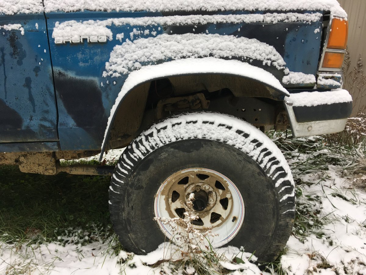

Stage 1 duff lift done
68839
second gen with 5” suspension and 2” body lift on 35’s. No trimming and home made flares. 3” James Duff coils and axle pivots, custom radius arms (mine), F-150 spring perches and 2” Duff poly body lift.

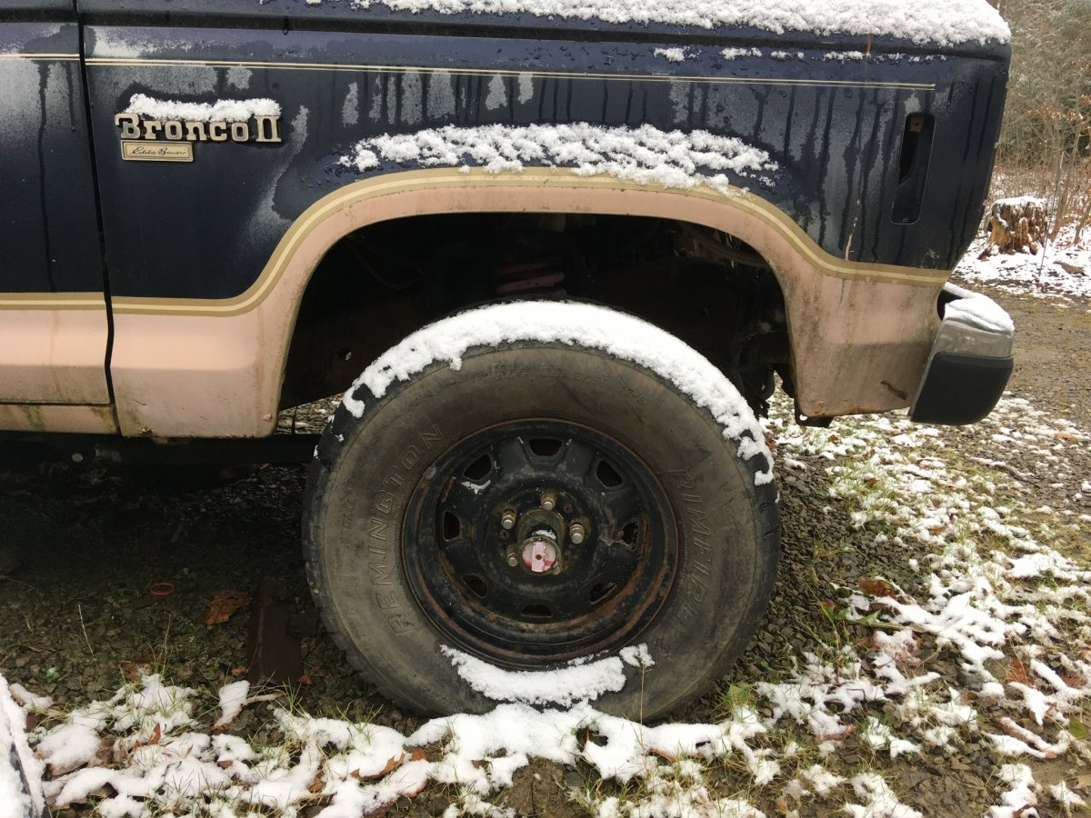

68840
first gen with 2” skyjacker coils and 30’s. Mind the engine bay is pretty empty so it will sit a little lower once everything is back together. I’m adding a 1” body lift which isn’t in place yet. Also has custom extended radius arms (mine).
