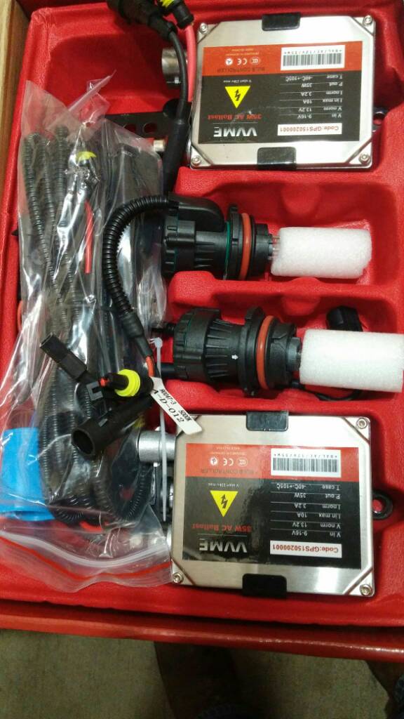

I have them. They look good but the ones I got don't fit perfectly I'm going to eventually grind down one side a bit so they fit flush. Also the shape and throw of the light leaves a lot to be desired. The projectors are aimed down a bit so they are really meant as fog lights. They are halogen projectors but they do have a cutoff inside but it can't be adjusted. It's been about a year since I got them and the clear coat is starting to peel.
I drilled the projector rear out and used hids
I used a kit that would fit my main headlight, in case I ever want to swap them but I doubt it. They are a dial stage set with mini ballasts an eBay special didn't want to spend too much in case they look like shit. Good thing because they need major tweaking. The cutoff works but it's not ideal.
The projector itself isn't removable so you'd have to drill or cut it out to fit another in it's place you're better off modifying a stock housing.
