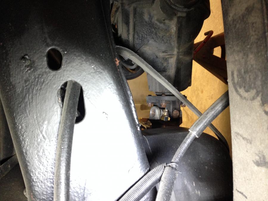

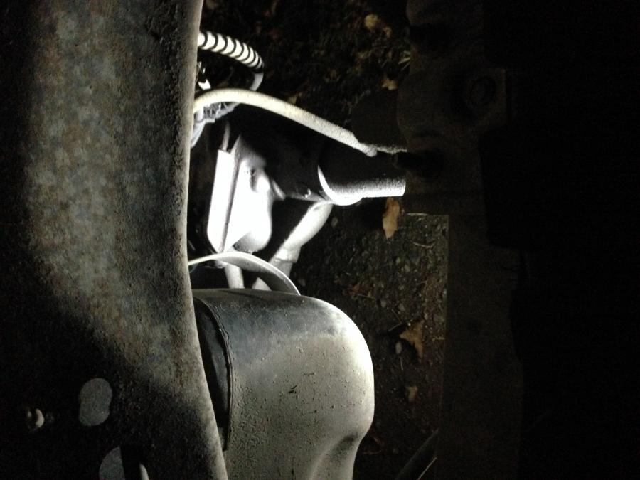

Idk, but my '92 long bed has the seldom order optional (standard is ~16 gallon) larger capacity gas tank that just so happens to have the same ~19.6 gallon volume as the extended cab. I do NOT know if its the exact same tank as an extended cab but it was only optional on long beds. When I compared it to my other long beds 16 gallon tank I noticed it went further back towards the axle. Hopefully you can see the relation between where the parking brake cable goes through the frame vs the end of the gas tank in these pictures.
