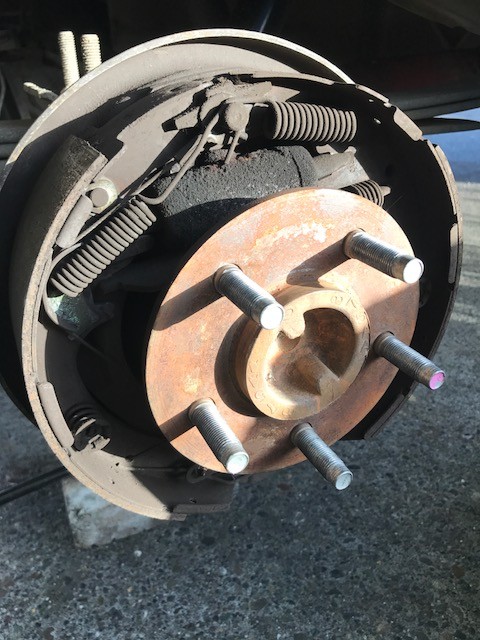

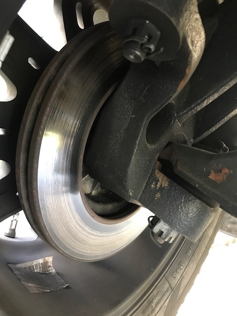

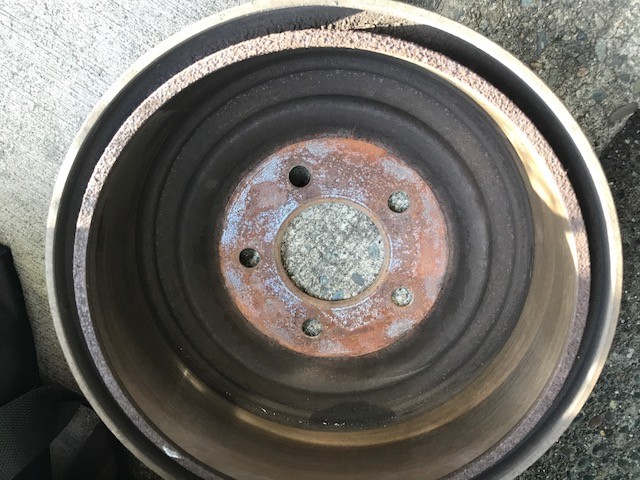

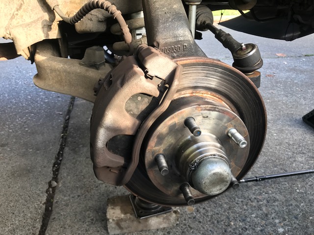

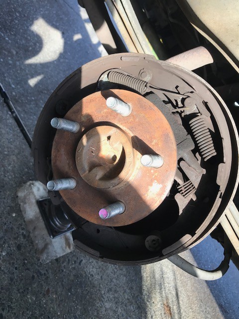

2000 2wd Ranger. Recently had new tires put on, and since them have had them rebalanced and one replaced (faulty tire was out 12 ounces). Drove with the window down for the first time in a while and noticed a sound like there was a rock in my tire... kind of a clicking? Sounds like it's coming from the tire that just got replaced, but hard to say for sure. Only happens when I get above 25-30, and is in rhythm with tire rotation. Stops when braking. Checked the brakes, but couldn't see anything obvious. That being said, I'm not as familiar with drum brakes. Did I miss something? Any other potential sources? There was no play to indicate wheel bearings, PSI is good, I don't know what else to check.

Definitely aliens, that's the obvious answer. That old zip tie trick is funny if you know that person will not look under their vehicle. I would take the questioned tire off and roll it on a concrete floor or pavement to see if it is something stuck in the treads. If it stops when braking then I would think its something in the brakes. Could be a loose wheel weight too.

You might be the closest one yet- didn't hear the noise at all today. Hope that means it's OK for freeway tomorrow!
The sticky stuff wore off
