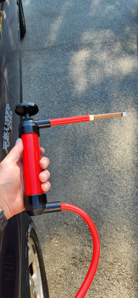

Stole this from a youtube video, but I grabbed a small hand transfer pump from harbor freight for less than $5 and a single black 'n mild cigar and made a cheap smoke machine. Worked great, I found a leak at my PCV valve with it.
That's actually genius. And cheap. I love it.

Stole this from a youtube video, but I grabbed a small hand transfer pump from harbor freight for less than $5 and a single black 'n mild cigar and made a cheap smoke machine. Worked great, I found a leak at my PCV valve with it.View attachment 132334
Hey, just picked up the exact same ChiCom pump from HF... now for the OUTput hose... I assume you disconnect the intake tube from the MAF housing, and... use a rag(?) to fill up the huge diameter difference, then pump in the smoke with the engine OFF...? Help a noob out here... :sneaky::icon_confused:
PS: did you try to use the tire-pump feature of this unit? I could NOT force the Schrader-chuck into that THICK-walled black tube with the TINY Inside Diameter!... silicone?
I pulled a vacuum line off by the throttle body and the red silicone hose that came with the pump fit onto it pretty well. Yes, do it with the engine off. I'd send a pic, but my engine is out and torn apart now! 😬

GREAT TIP about the vacuum hose.

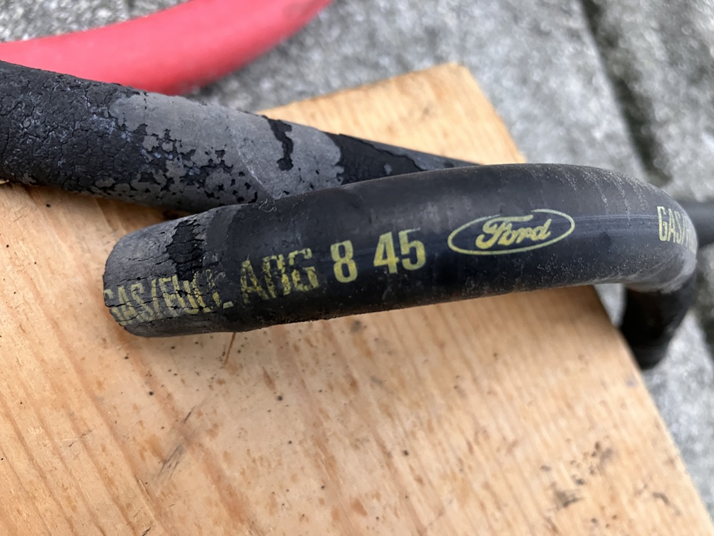

OOOo-KAY!... finally did the smoke-test, and NO visible leaks, BUT... that vacuum hose you pull off the driver-side throttle-body is GONE, dry-rotted, just one long slit, open to the atmosphere... that would probably do it, right? Sucking in UNrestricted air WAY downstream of the MAF and even the IAC (which would explain the rough-idle at startup, but smooths out later on, eh?)
I'm YEARS behind replacing each and every VACUUM hose... so many different sizes involved... NAPA here I come. (The one I'm talkin' 'bout here is 5/16" or 8mm...??)

ALL-righty then, got some snazzy RED heater hoses 'tween my purge valve and throttle-body suck-point (only TEMPorary, cuz heater hose is NOT fuel-rated, and basically there's gasoline fumes being sucked through there, right?)...
... started COLD engine and Idle is immediately better! LTFTs both down to 21, STFTs down around 0 to -3%, didn't have a chance to drive it around or even warm it up, but I briefly rev'd it to 3,000RPM and IIRC LTFTs dropped to 14-15...?
Wish I had mapped MAF volumes to RPMs earlier... can always pull that hose off and do so... CLEARED the codes, will be in-town driving tomorrow, and see if they recur.
Here's the markings on the old hose... can't believe it only lasted 27 years! :ROFLMAO: The side you can't see is one long slit where it collapsed on itself.
Anyone know what those markings/#s mean?... size? Gauge/thickness?
