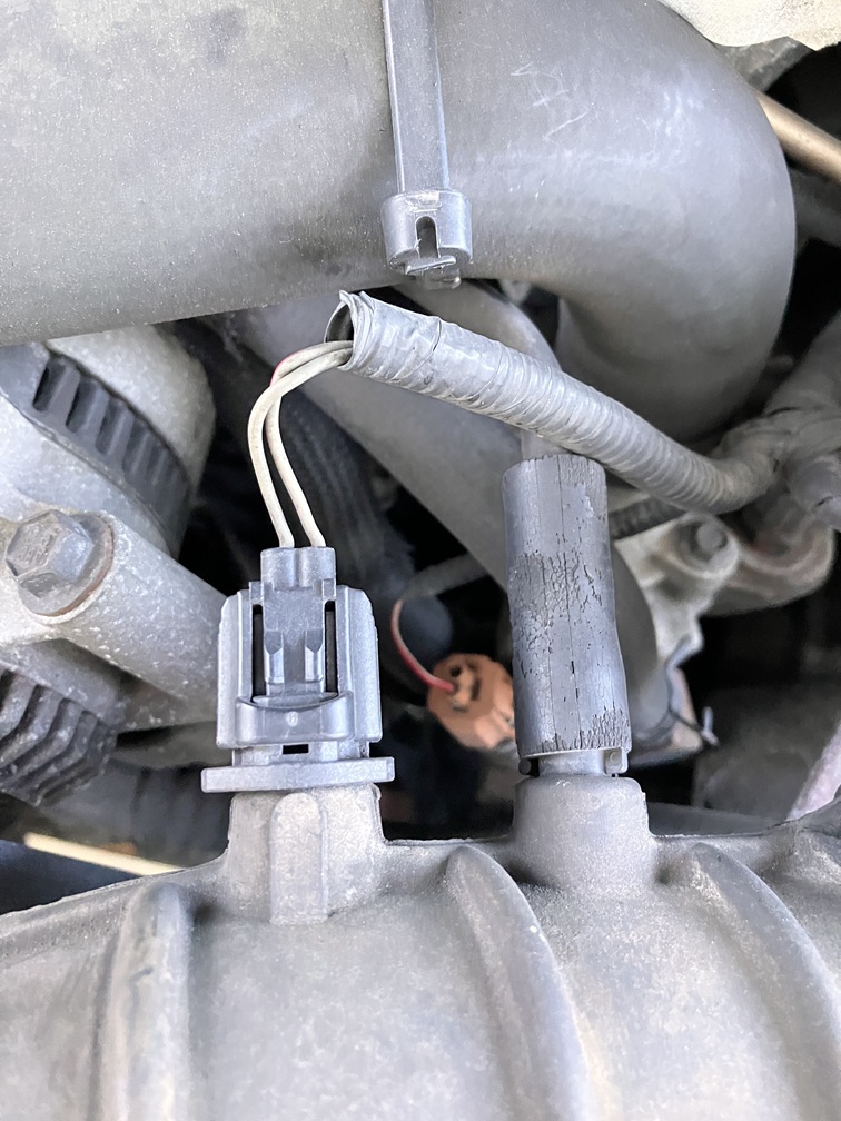

OK, here's a pic of the breather hose connector, at about the halfway point on the snorkel/intake tube, looking rather aged and CRACKED... guessing that's the IAT sensor next to it...?

Should probably use some tire-shine/Black Magic on Ye Olde "elephant trunk"... :stirthepot:
that allows fresh air into the valve cover/crankcase which is later removed via the PCV valve and sent back into the intake.
the hose from the PCV back to the intake can get very hard, cause leaks.
