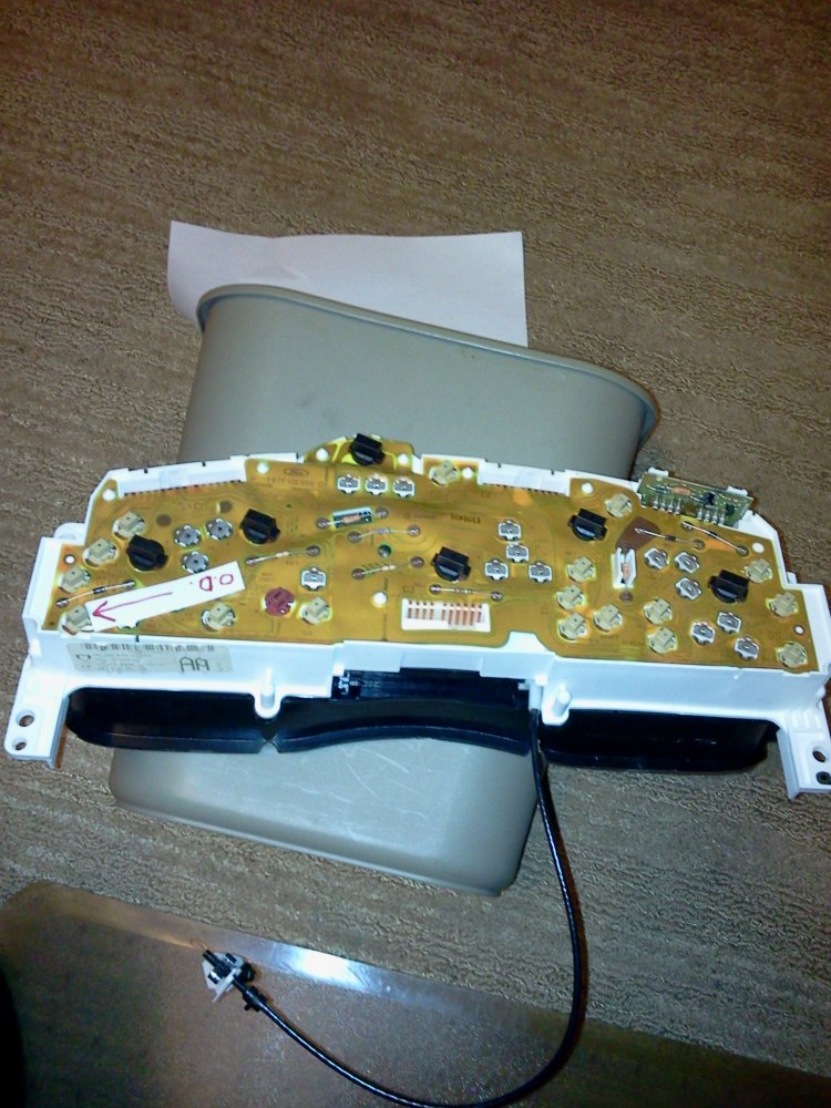

SOLVED - O/D Off Button not working - No O/D Off light on dash when button is pushed.
The dash light bulb should come on whether the system or button works or not. When you first turn the truck to run position all the warning lights come on specifically to test that the bulbs work, and for no other reason and in no way correlate to that systems status or functionality. Just tests bulbs...

Bulb seems almost guaranteed, but doesn't explain the extent of the issue.
Were it me... I'd pull the cluster and check/replace the bulb. While there, I'd also pop apart the pieces to access the switch and wiring. The whole teardown shouldn't take particularly long. You can swap the bulb and troubleshoot the switch issues at the same time.

Take apart the cluster and surrounding trim following the video linked previously. Pull the top and bottom cover for the steering wheel.
Replace the bulb and reinstall the cluster - test that the O/D light works now.
Once you've done that, follow the wiring off the shift lever to the connector. It's not far down as I recall. Disconnect the connector. With the key in the run position, use a jumper wire to momentarily connect the two wires on the vehicle side of the connector. This should switch the O/D mode to off. Jumper it again to turn it back on. All you're doing is mimicking the function of the button at the end of the shift lever.
