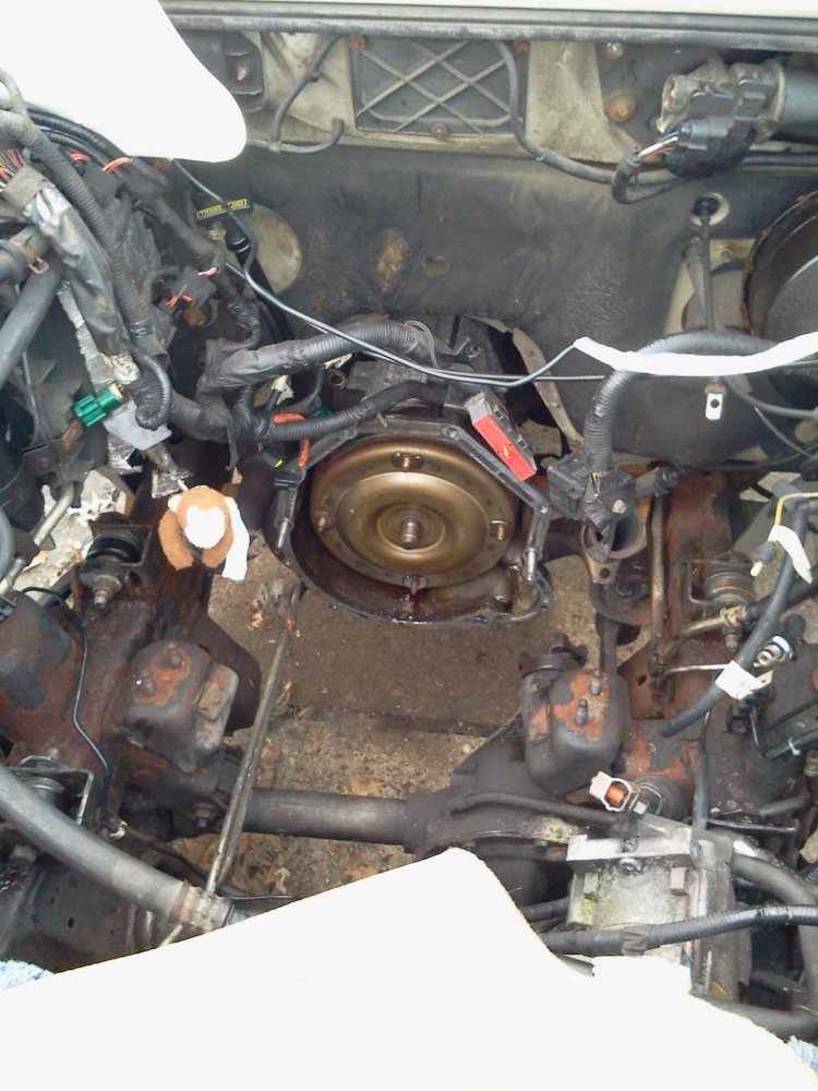

well, this thread got me motivated. I actually went out and investigated the check engine light (that's burned out)
46898

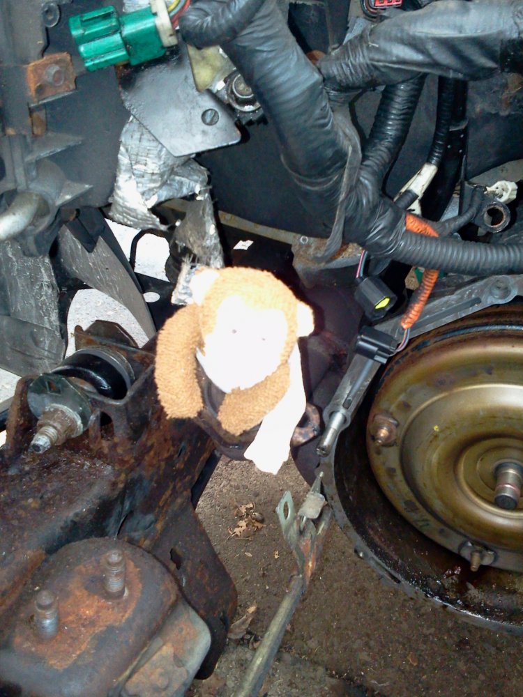

seems a darned critter clogged up the exhaust. oh well, easy fix.
46899
Better be careful, that monkey probably pooped in your exhaust.
