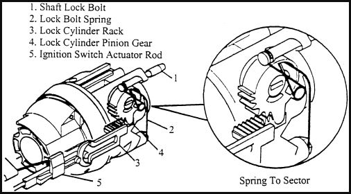

Went through ten pages of search results here. Apparently, there is a little rack-and-pinion setup inside the steering column that might be gummed up and need lubrication. The scary part is, that the ignition switch cylinder is made of flimsy pot metal, and has to transfer all the torque of twisting to the pinion through a shaft or tang that can shear off, making a big problem that requires dynamite to correct (well, maybe just a drill and slide hammer, but who need more work?)
Wondering how deep into the column this part is?
Now I'm thinking I'll stop cranking on the key until I get this figured out, I'm trying to fix things once, not fix them until they are more broken.

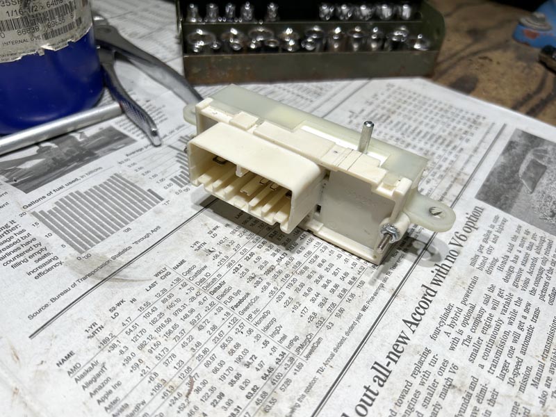

Once this was off, the actual ignition switch, the part with the wires that do the work, was exposed. It comes off with two Torx cap screws. The action seemed kind of stiff to me, so I drilled out the aluminum rivets holding it together and opened it up. Nothing wrong inside, adequate yellow grease and nothing binding, so I smeared any blobs of grease around and reassembled it using 4-40 machine screws and nuts.
With the switch off, I was able to turn the ignition key with one hand, but it was still pretty stiff. Jiggling it, I could see that the first section of the plastic rods was freely moving. (who designs this stuff with plastic parts, anyway?) The second rod, the front-most one that actually moves the above switch, was not sliding easily. It looked like I was going to have to pull the steering wheel and get at this stuff to find out why.
