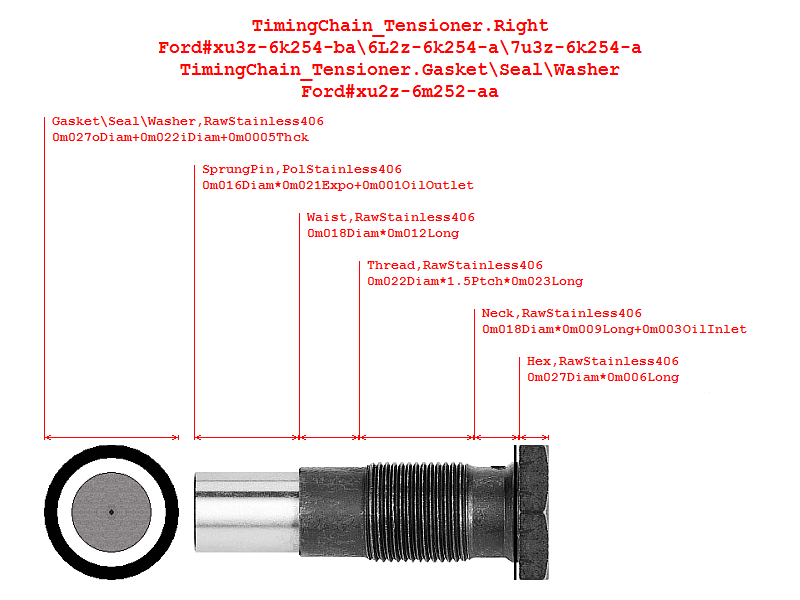

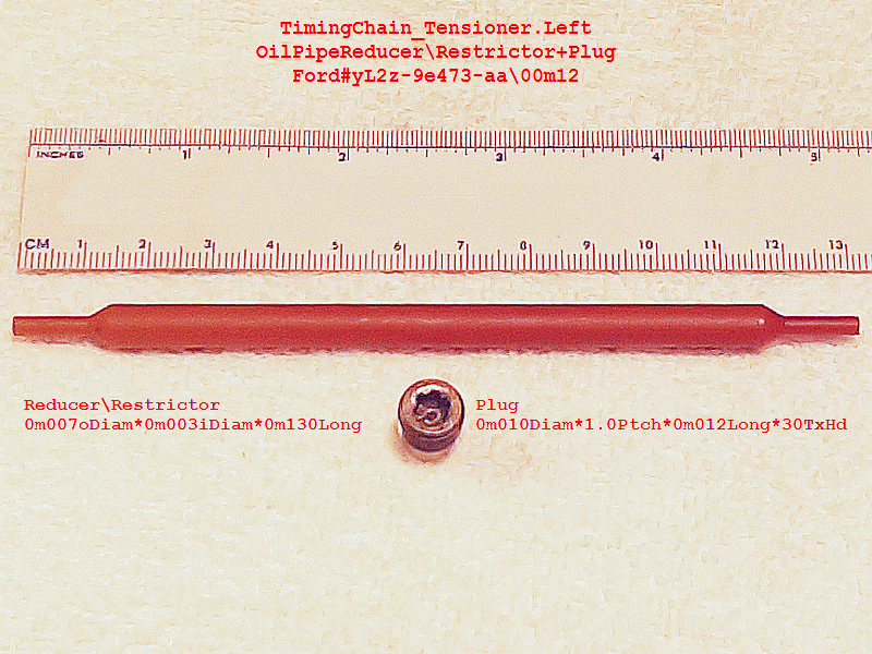

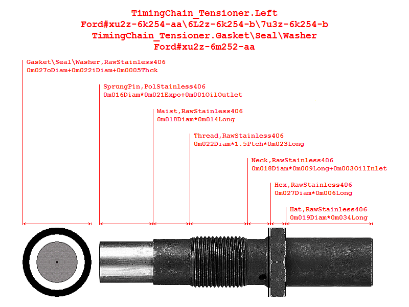

You're correct there are 3 or 4 total TimingTensioners in the V6~4.0L~SOHC:
* LeafSpring TimingTensioner on the front Jack TimingChain
* LeafSpring TimingTensioner on the front Balance TimingChain (if your engine has a Balance TimingShaft, most after ~2003 do not)
* OilPressurized TimingTensioner on the left Cam TimingChain
* OilPressurized TimingTensioner on the right Cam TimingChain
The right can be changed relatively easily.
The left requires removing some external parts.
The two LeafSpring Tensioners require removing the CoolantPump & front TimingCover.
The concensus is to change the left & right every 75k~100kMiles.

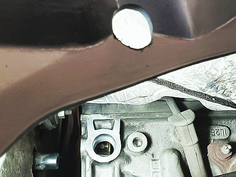

The tensioners of prime concern are accessible from the right wheel well at the back of the head. The left tensioner is under the intake in the valley. You need to remove the thermostat housing. There are a few videos on youtube for the job that will give you a better idea what you are looking at. It’s too hard to properly describe it with just words.
