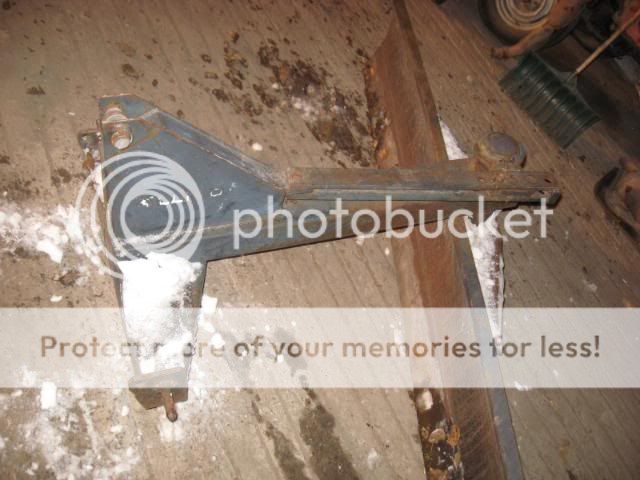

I bought a 3-point hitch style snowplow a few weeks ago and have adapted it to fit the front of my b-II.
What I brought home.

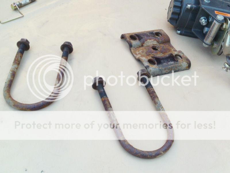

I figured I needed some type of shock absorption so I adapted some leaf-springs, you can see how I bent them in this thread;
http://www.therangerstation.com/forums/showthread.php?t=120826

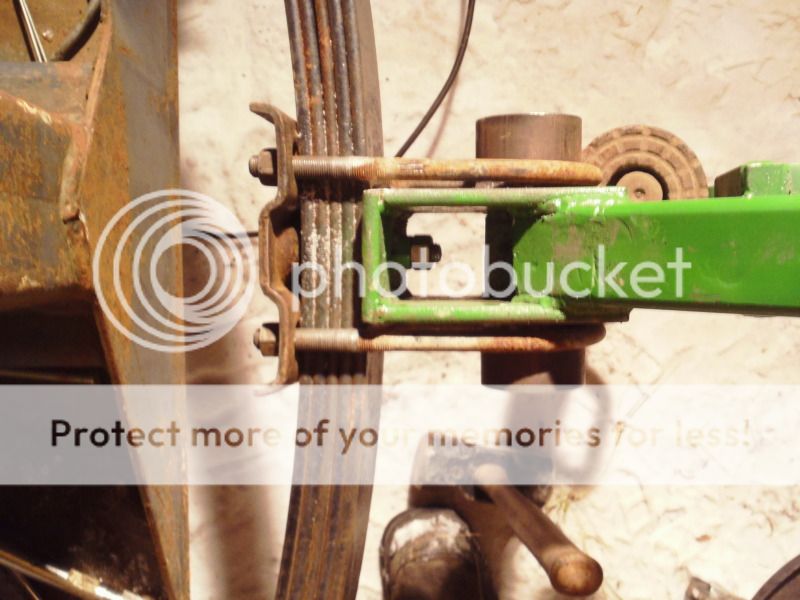

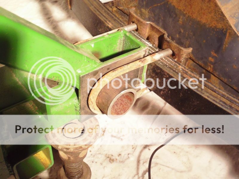

You can see in the following pic how I mounted the leafs to the plow to allow for leaf movement;
After a lot of head scratching and a few false starts, this is what I came up with;

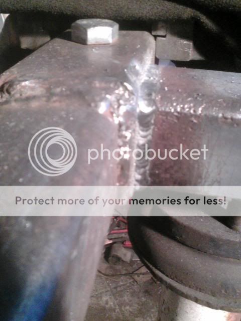

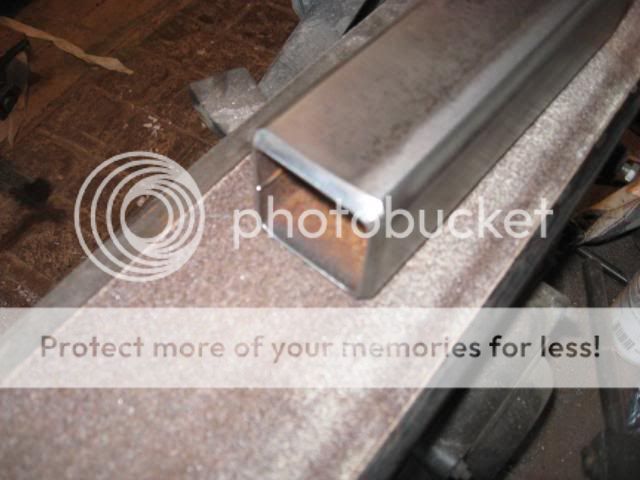

I ground out a 45 degree relief for welding
Started to weld. The goober looking weld is not mine.
Tried vertical up, It's ok but I can use more practice.
Ground out the goober weld prior to re-welding;

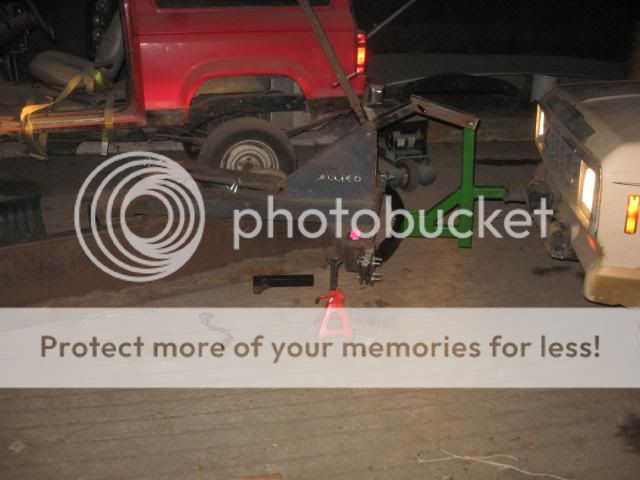

Right after I took those pics the plow decided to take a rest; I forgot to pin the contraption to the truck receiver....ooops :-[ But that did lead me to think about how I was going to lift it back up to re-install it. I had a bitch of a time getting it in the first time. So I have a spare wheeled trailer jack with a 2" stinger welded to it, I'll weld a short receiver to the plow bracketry to install a removable jack.
I also have to make something so the springs don't separate.

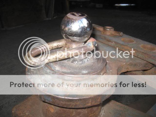

I'll have to get some close up pics to show how I ran the winch cable. The plow rotates 360 degrees so I came up with using a ball with a large chain link trapped under the ball before I welded it on. I ground two flat spots on the base so I could slip the link on before welding it to the front of the blade. Unfortunately I got ahead of myself and welded the ball on before slipping on the chain link. DOPE! So I cut a diagonal on the link, opened it enough to slip over the ball, squeezed it ,then welded it back shut.

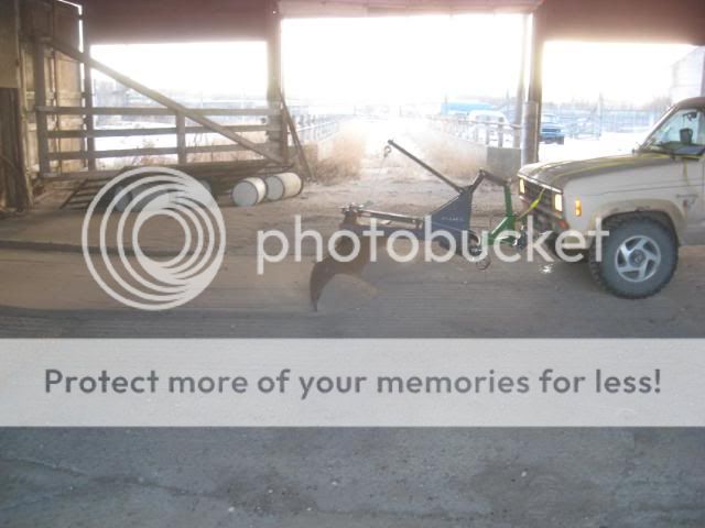

As promised/threatened, here are some detail pics;
the ball and chain link, I preheated the shank before welding as it was -10C and windy;

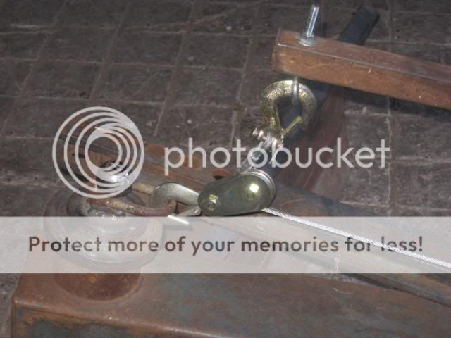

How the cable is run;
I used a piece of angle for the receiver tube, it's sloppy, I'll have to add some filler;
Temporary hook up for the winch;

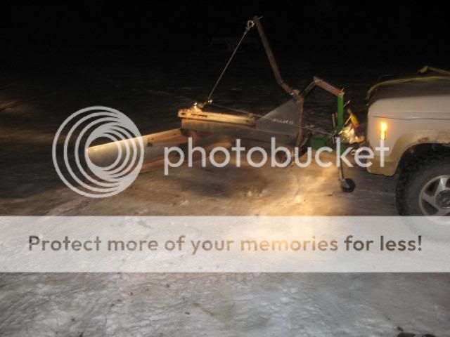

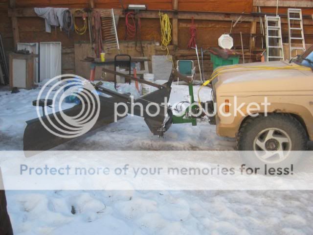

Trying it out in the hard-pack snow, now I have a reason for lights on top of my truck. You can also see that I angled the long bar that the end of the cable attaches to, I was trying to get more lift, failed;
As a first iteration I'm fairly pleased with the results. Maybe I should have done some research by seeing how snowplows are hooked with a three-point hitch [tractor] and on a truck before I started building this but I wanted something done before the next dump of snow. I should have put the stinger lower so as to raise the plow when hooked up, it's close but I can't quite swing the plow around for pushing when it's on the truck. Airshocks or bags or springs would probably solve that. If I can't find one of the first two I'll do the third, I have some 1/2 tons I can steal coils from.

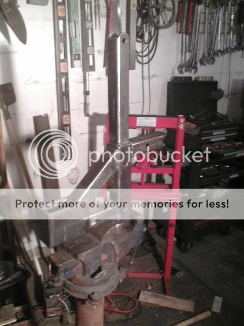

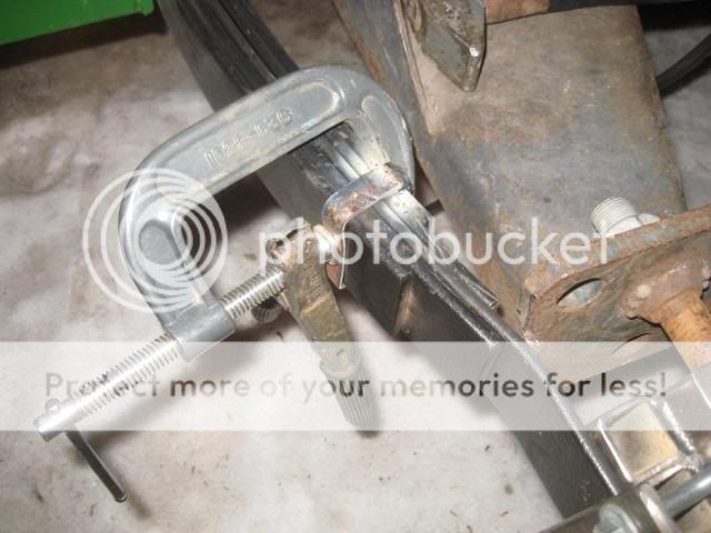

I made some clamps for the springs. I used some off cuts, ~1/16"x1/2"x~10". I used my vise to make the first three bends, then clamped and hammered the last bend and welded it on. I wanted to just bend the ends to hold it shut but didn't have the length for that so welded it instead. There should be enough slack for spring movement yet not so much that it slides where-ever it wants.

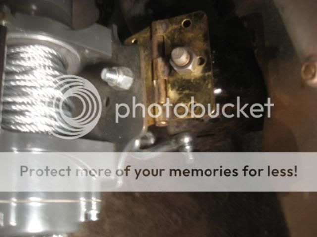

I also adapted a door hinge to hold the winch. I didn't like that the winch would roll over the exact way to make it harder to reverse the line. But I liked that it would keep tension on the line, so that's why the hinge. I welded it so that it couldn't pull apart at the pin, the fingers are just rolled and if enough force is applied, apart it will come. You can just see the discoloration in the plating, I welded on the other side.

Other than that it works good enough. I think painting would help with keeping snow from sticking. An extension up and forward would help with deeper snow removal. I'd like to experiment with see through material, I can get a 5'x8'x.118" sheet plexi-glass for $45.00. Build a frame for support. I see this getting scratched really quick but I think I'll still be able to see a blurry outline of whats in front; like ditches.

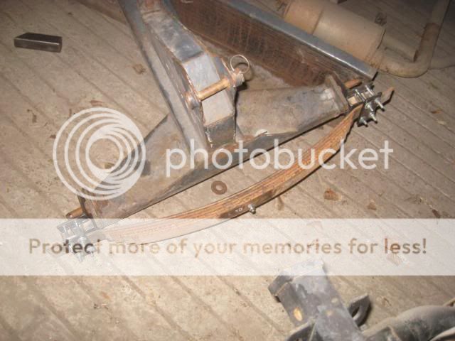

I finally replaced the way the springs are mounted to the adapter after breaking the 2nd 1/2" bolt;
I grabbed a spring plate from my scrap/parts pile;
I welded some tube to the adapter and mounted the springs, I think this will work much better;
There is a headless bolt centering the springs, same as a stock set up.

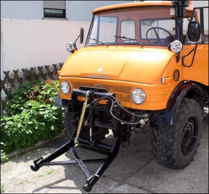

I don't know if you have a way to adjust the bite of the blade, it looks like it is going to bite really good going backwards (hitch is tipped down) but float going forwards. Normally you would use the turnbuckle style center (top) link to adjust this.
If you have a gravel driveway you may want to put skids on it since you can't see what all is being pushed by the blade.
Here is now they mount on a tractor if it helps you any, I am modifying my 3 point hitch because I got a bigger blade and need to pick it up higher so it will be a bit if you need different views.

Thanks for posting the pic, it helps me visualize a stock set-up.
