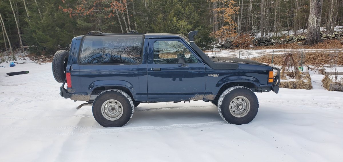

Howdy ya'll,
I am thinking of installing a 60 series land cruiser snorkel on my 89 BII (and yes...I know what they are for and all the pros and cons. I have one on my Tacoma). Can I replace the factory airbox and filter for an aftermarket one? Any thoughts on what kind and where I coudl track one down?

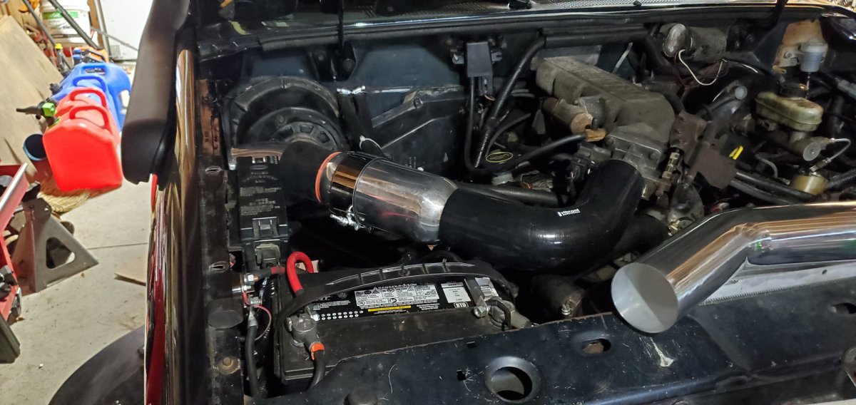

I ended up using the spectre 4 inch filter. we shall see if its any good in the long term.

For anyone wanting to do this - the 60 series snorkels fit good enough. You need to make your own template out of cardboard though. Do your best with the template, hold your nose and drill! Also, I had to cut the 90 degree elbow off the snorkel, so it was just straight. Finally, I had to move the starter solenoid and the “power distribution center” forward a few inches.
